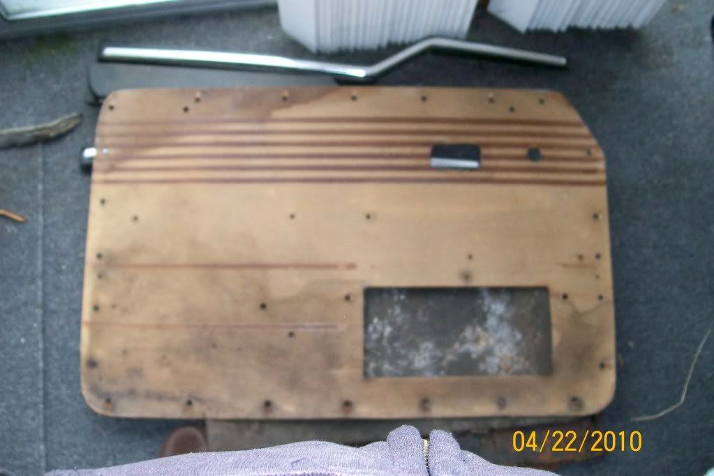

Anyone got pictures of the front arm rest mounting for their '67s? When I purchased mine she was gutted. Just need an idea

This is a 67 door card. The first screw hole 11" up from the bottom and 2.25" in from the leading edge.

The arm rest is attached to the panel only, not the metal?!
No there is a clip on the back side of the vinyl door panel that is bolted to the arm rest and slides on to a tab that is welded to the door.

flyinglow94 wrote:
Part #111867185
