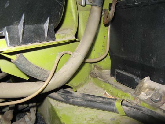

PostPosted: Thu Apr 29, 2010 4:58 pm    Post subject: High Altitude Switch Reply with quote
busdaddy wrote:
Welcome,
This switch sounds interesting, could be something that alters the resistance of temp sensor 2. Pictures would be very helpful here, of the switch, where the wires from it go and the throttle body as well
Thanks for the reply! The 1st pic shows the switch mounted just above the CU connector. The 2nd image shows how the leads join into the main wire harness that leads to the double relay mounted on the upper part of the left firewall. 3 wires branch off about mid engine and disappear under the air distribution box and I can wiggle them by grabbing a lead on the Temp Sensor II near Cylinder 3. It's all black magic!

PostPosted: Thu Apr 29, 2010 5:24 pm    Post subject: Reply with quote
pb24ss wrote:
Where in Colorado are you? Have you ever hooked up a timing light and flipped the switch and compared timing at idle and under load?
Hi pb24ss. I'm up in Fort Collins and I did hook up a timing light and no, it didn't make a difference either way. As I read the threads supplied by busdaddy, it sounds like this harness and switch were only on European models. Mine was bought in Greeley and came from Houston by train. I don't think it ever saw Europe except in manufacture. I looked at the original invoice and it stated the High Altitude kit was added.

Karl's old posts state that USA ecu's don't have the circuitry to take advantage of this. However that would imply your ECU would have to have a different part # than a typical USA bus. Maybe you could pull your ECU and take a look at the part # and compare with the ratwell table here:
http://www.ratwell.com/technical/FISwap.html#ecu
Obviously if it does anything it must affect mixture only... there's no way for it to alter the timing which is controlled by vacuum and centrifugal force.
