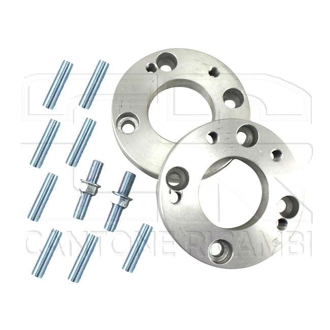

PostPosted: Fri Mar 05, 2010 12:39 am    Post subject: Reply with quote
No. It's possible to have both, 4x130 and 5x130 in the hubs.
Basicly bolt patterns look like this:
I just have to drill 5x130 to drums.
Ill take pics when I get them back from machining

PostPosted: Thu Mar 11, 2010 5:28 am    Post subject: Reply with quote
Hubs are back. Cost 0€ Razz
