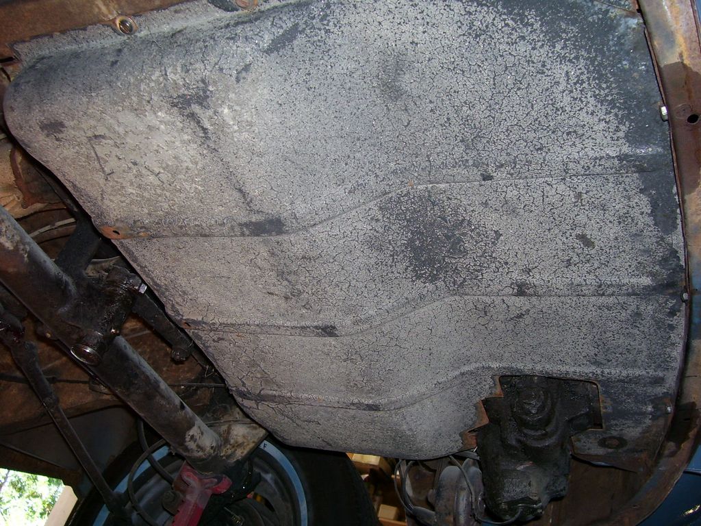

Barndoor:
Early style (55-60?):
Note flat area around steering box cutout.

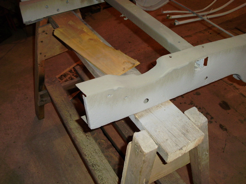

For 55-57 the front lip where it bolts to the nose is also flat, later Buses had those areas pressed outward a bit, see later examples below:
Earlier pans (55-57?) have this highlighted area spot welded on - note this first pan shown was identified by a member as a 65-66 pan and is just highlighted for reference

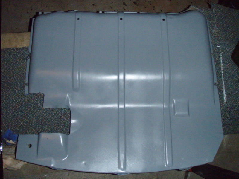

Mid style - exact year range unknown:
(Correct for 61-66(?), will correct as information is posted)
Note bump where master cylinder switch is located, this was possibly added when the change to push-terminal connections was made:

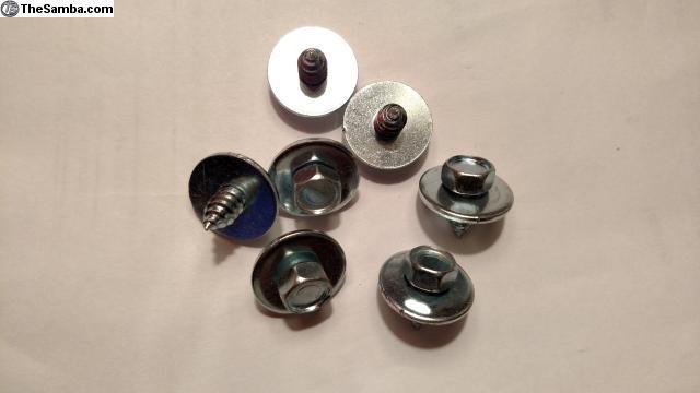

10mm headed m6 bolts. Same bolts used on the generator tin to bolt to the fan shroud.
10mm headed coarse screws. Same screws used on the brake line mounting tabs.
(These are aftermarket but same general appearance)
http://www.oacdp.org/5867part/345.png

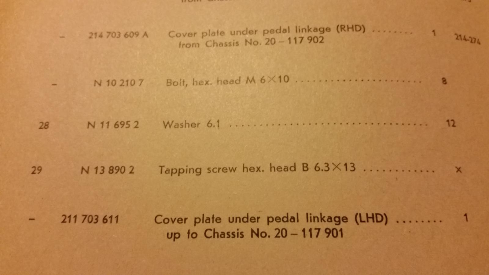

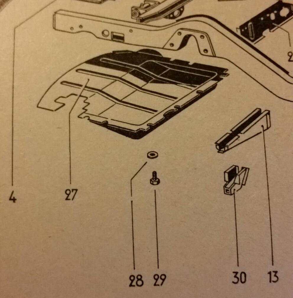

6x10 bolts - Quantity 8
6.3 x 13 self tapping bolts #29 - Quantity X
Why X? Maybe it varied year to year?

PostPosted: Mon Mar 08, 2010 10:59 am    Post subject: Reply with quote
awesome thread/post,
the early ones 55-57? are flat where they mount to the lower inner nose section,im not positive when this changed but the later ones were relief pressed on both the inner nose and splash pan

PostPosted: Mon Mar 08, 2010 11:14 am    Post subject: Reply with quote
Any pics of that(?), as it is what I am looking for.

PostPosted: Mon Mar 08, 2010 12:02 pm    Post subject: Reply with quote
Oh? Pics would be great, I can add it.
I know I have heard people say that the very early pans (55-56?) have some parts that are spot-welded on, like they were made in multiple pieces.
Pics needed of that as well.

PostPosted: Mon Mar 08, 2010 12:10 pm    Post subject: Reply with quote
i have several different 55-58 buses here,i will see if i can see the inner nose panel change cut off (roughly) by comparing my inventory,i have big stack of early pedal pans but they are seriously buried,maybe someone else has some that are easy to access?
im going to guess the change is when the tailights changed in 57 as theres a bunch of little things that are new in the mid 57 buses
edit,your pics actually show the non relief pressed edge on the early pan....
