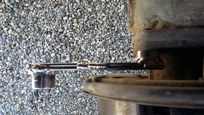

Hey all. So I have a van I'm working on where there's basically no need to mess with the rear bearings. At the same time, the owner is getting a whole new suspension system and the rear trailing arms need to be removed for reconditioning. In the past I've just removed the big nut, taken off the brakes and zipped off the four 22mm bolts holding the housing to the trailing arm. I also have a ground down 22mm wrench to use, but it's a 12 point so not the greatest thing to be breaking tension. And then there's torquing it back down too. So today I decided to build a tool just for this job. Here's what I came up with...
First I measured the thickness of the bolt head.
Then I gathered the parts I needed. I used a six point 7/8 socket. Why 7/8? Well, because I felt it was better to cannibalize than my metric one basically. I also found a scrap piece of 3/16" flat bar and then fired up the old Keller power hacksaw to make another one. It's roughly 7" long.
The old Keller still working strong after all these years.
I then measured down 15mm from the top of the socket and cut it off, and prepped the flat bar for welding. 15mm which leaves me room for the big fat nasty bead I'm going to weld to hold it down.
She's an ugly beast, but she's built for strength not looks. I went ahead and welded the remaining bottom end of the socket on the opposite end so I can use a 1/2" breaker on it and for torquing down the assembly later when it goes back together.
Here it is on the Vanagon rear bearing housing about to do its work. The 15mm section of socket sits nice and flush against the housing. It's strong enough to wack on with a hammer or simply use a 1/2" breaker bar.
So there it is. I thought this might come in handy for someone. It would certainly come in handy if you had a stuck 46mm castle nut and needed to take the assembly down to a shop to have it zipped off. Especially if the van was up on jackstands or was otherwise not able to be driven down to the shop.

Thats a good idea. I think a box wrench can't engage the bolt well because of the bearing housing casting but a short socket fits into the machined spotface.

Thanks guys. You both describe the problem well. 1- There isn't enough room to get any regular socket with ratchet or breaker bar between the bolt and brake backing plate; and 2- The spotface (machined flat) on the bearing housing is not wide enough for an unmodified box end wrench to sit flush on it. Besides having to grind away the box end for clearance, one is still stuck with the awkward angle and then running into the neck of the wrench itself which naturally wants to push the box end up and off of the bolt through the rotation. Also, most combination wrenches sold are twelve and not six point.
The tool worked awesome, btw. It stays on solid, fully engaged with the bolt, and with a six point there's zero fear of it causing damage. I tried both slugging it with a hammer and using the breaker bar and both methods worked with ease.
