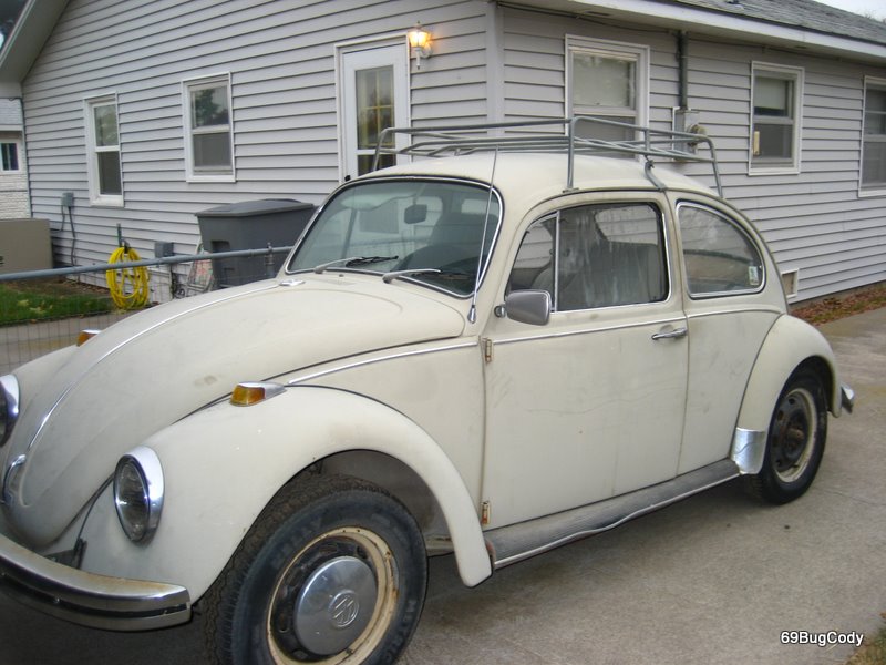

Back in October 09 I purchased this 1969 VW Beetle for the whopping amount of $400. I purchased it from the original owner who got it brand new in 1969 (even has original dealer license plate frame on it still). It had not been registered since 2000 and has basically been sitting since then. No serious rust, pan still solid. We wheeled it onto a trailer and drove it to my house. Along with the bug, I got the roof rack (score!), brand new muffler and 2 sets of chrome tips, and a box full of parts/gaskets. Also came with Muir's book, how to keep your VW alive. Being a first time bug owner I figured this was a great purchase.
Here are some pics from the day it arrives at my home

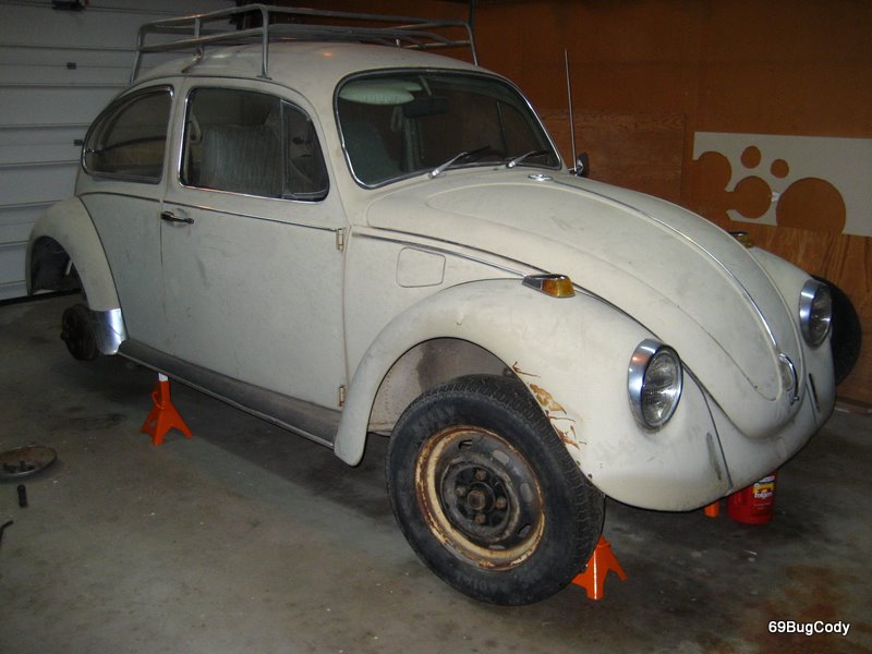

Since then I have gone through the entire fuel system (replaced all rubber lines/hoses, new fuel pump, installed fuel filter) and painted/cleaned my trunk up.
Started as this
Now looks like this
The last few weeks I changed oil, repaired the bent clutch pedal and unstuck the back brakes. Brakes were way over tightened and filled with grime. A little brake cleaner and cleaning, all is good now. Also threw in a new battery and got it "running." It runs if gas is continually poured into the carb, so not really driveable yet. Fuel pump is pumping gas so that leaves the carb to be at fault. It is a solex 30pict-2, trying to decide if I should attempt to do the rebuild myself or maybe send it out to get rebuilt.
Here it is at it currently sits in my garage.

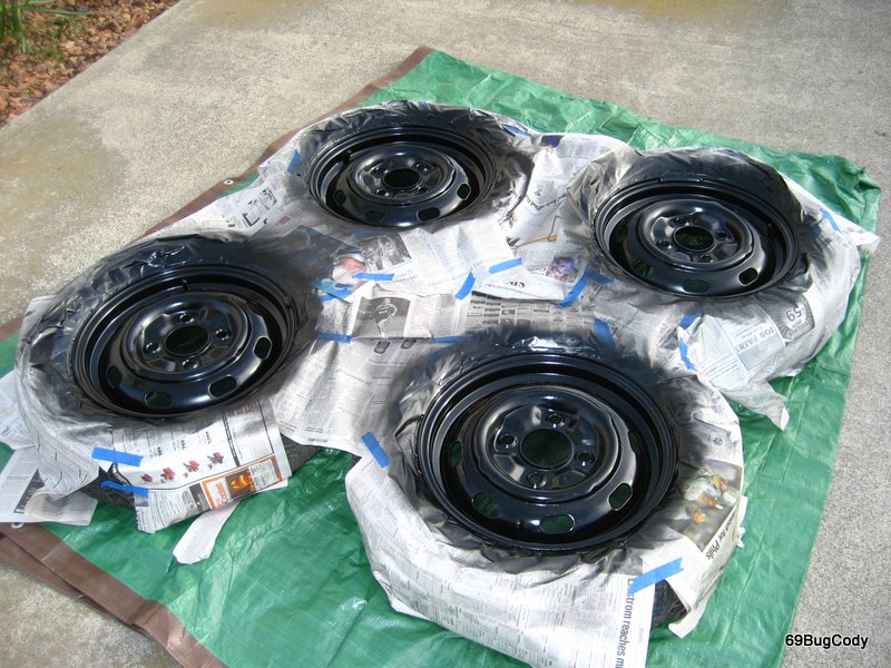

Had some down time this weekend, was tired at looking at the rusty original wheels so I threw a few coats of satin black krylon on the original wheels. Figure I will be using these till I narrow the front end and get the Performance Industries Mags some new tires. Might as well have them look semi nice Smile
Going slow on this bug, but I guess one step at a time...

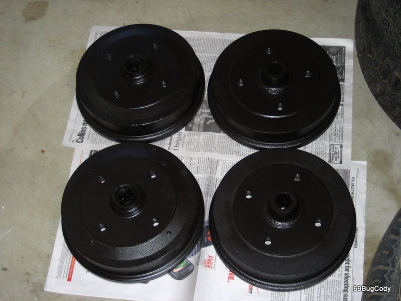

PS Yes I know I already have a set of mag wheels... I just could not pass up the deal. Cleaned them up with an SOS pad Saturday, here is a pic
Installed battery after pounding down the floor pan (previous owner must bounced over a few rocks). Rewired a fuse holder on the engine (brake light one), lights are all working but right blinker probably is a bulb, will replace later.
Rear brakes locked up again (just like when I bought the car), loosened adjusters on the brakes. I then stepped on brake pedal and now all 4 corners are completely locked. Figured since the car had sat for 10 years, I should go through the entire brake system. Ordered new MC, wheel cylinders, brake shows, hardware, and some braided stainless steel brake lines. Figure safety come first.

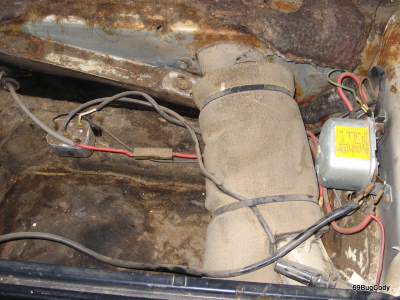

Oh and maybe someone can help with this issue I have.
Under the rear seat are the 2 heater y-tubes. They are wrapped in insulation (see first pic). Previous owner must have had a little fire by the battery and that insulation kind of burned up. I tossed it as it was pretty much toast. Where do I get this insulation piece? Currently it is uninsulated (see second pic) Thanks for any tips/advice

Cool 69! Cool
Heater duct insulation is hard to come by. Pretty much non available and would have to buy a used one or make your own.
MAM however has these foiled-backed pieces if that style suits your taste.
http://www.mamotorworks.com/acvw-air-cooled-vw-interior-sound-deadner-kits+1950+1979-1-248-7885.html (number E down the list)

Ok cool, I figured they were hard to track down. Is there a cheap DIY material I can pick up for the same purpose? Basically looking for a fireproof 1/2" - 1" thick insulation?

Following the advice on the forums I ended up wrapping the passenger side heater tube in some fiberglass insulation. Just got a roll of it, 3" wide by 1/2" thick... maybe should have done 2 wraps but we will see how well just one wrap holds up. Used zip ties to hold it in place.
I received all my brake parts, so getting ready to install all that. I ended up ordering all new shoes, wheel cylinders, springs, stainless steel hoses, and a new master cylinder. Also got a new reservoir that mounts right on the m/c so I will be able to get out the leaky mess that is under my hood. Before going about this decided to clean up the drums and check to see if I needed to get them turned. Looked fine, so just cleaned them up painted them with some high temp black spray paint.
