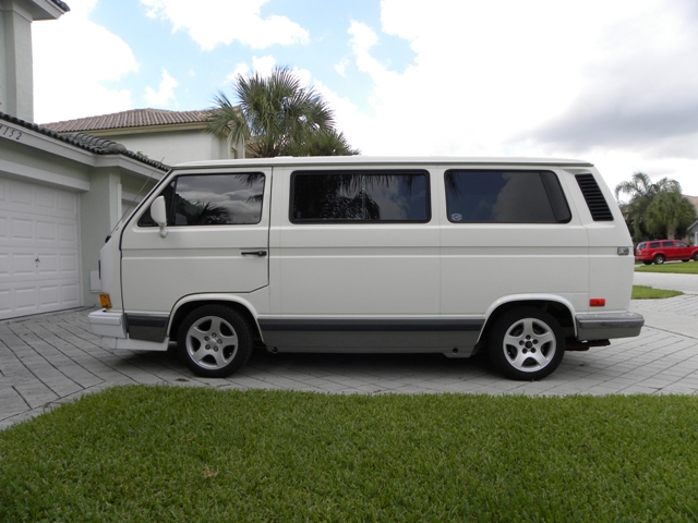

This is my and my sons work in progress.....
Its definately lower than most... this was done by the previous owner and if interested I will look for manufacture/part numbers for the springs and shocks.
