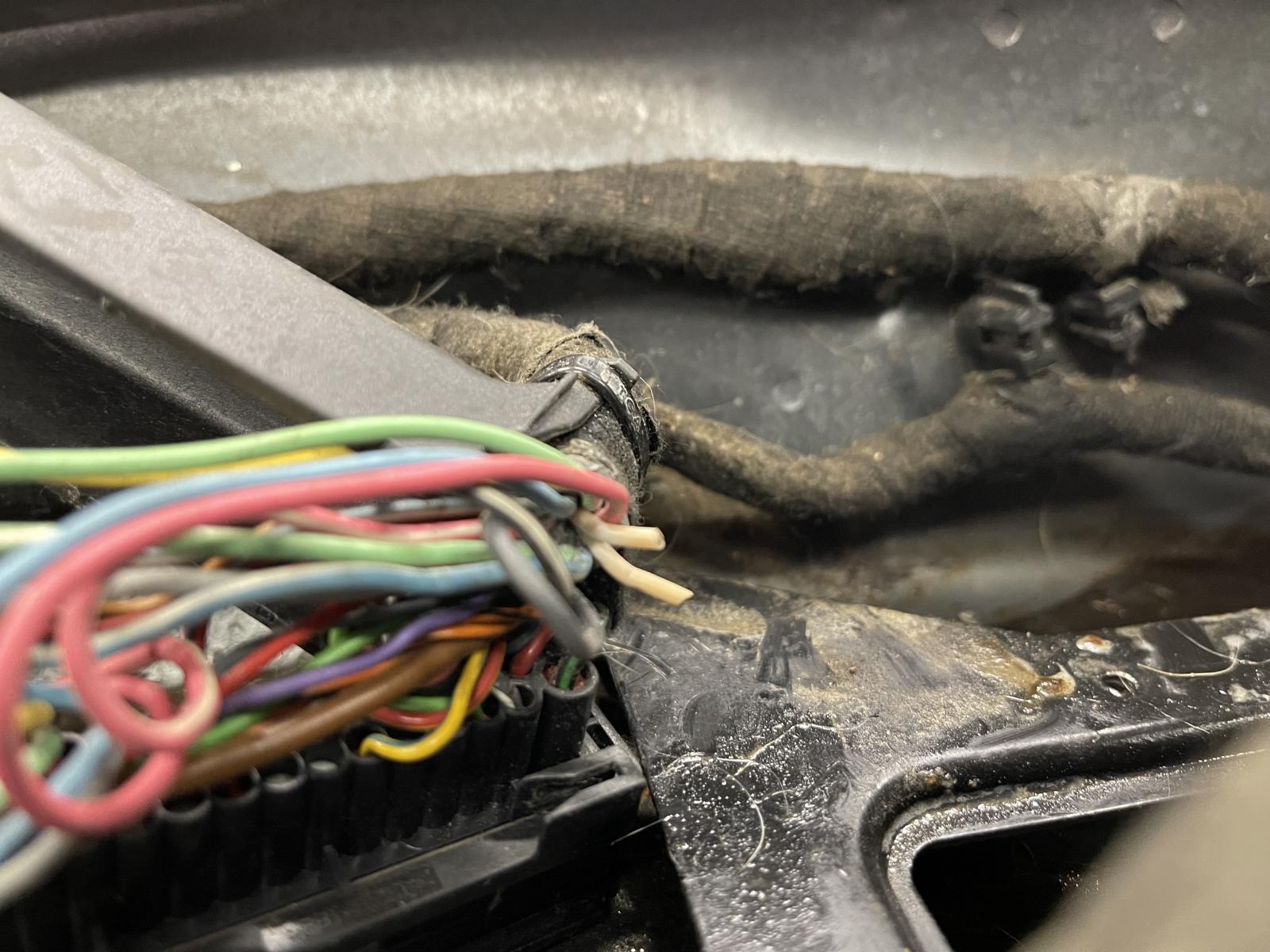

Hi, I’ve got a 2002 beetle with the 1.9tdi and the 01m transmission. And as of now it is stuck in 3rd gear, (can shift it manually up to 3rd) but I can clear the code it has with a snap-on scanner and it will shift perfectly normal. Soon as I shut it off and restart it, the code comes back and it’s stuck in 3rd again, which I understand is limp mode. The code it throws is “65535 checksum error - ecu defective unknown subcode.” Anyways I tore the dash apart to check the tcm and ecu and found I had a really bad mouse problem. While inspecting wires I found on the back of the tcm plug there was 2 little white wires the looked cut but they didn’t have a place they went into the plug itself. So I’m not sure if they are suppose to be cut or if they are suppose to be connected to something. Hoping someone knows. Thanks.

The white wires don't really look "nibbled on" (I assume that's what you meant by "mouse problem") but cut. Do you see what they would have connected to?

Any other forums you’d recommend then? Also I agree the wires do
Not look nibbled on and the plug has no matching wires or empty holes for that matter. I just did know if they were connect together or not. And I sprayed some maf cleaner in all the plugs and such to clean them. Still no help. Cleared all the grounds in the dash, no help. Kinda at a lost here.

A good wiring diagram would help you locate the purpose of those wires.
