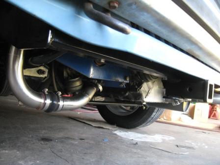

PostPosted: Mon Apr 12, 2010 2:50 am    Post subject: Reply with quote
Nip Tuck Laughing
Here is my custom oil pan:

A friend of mine has carried out his own TDi PD engine conversion in UK.
Here are a few pics...
He has made his own adaptor plate and mountings and runs the full dash etc in the van.
A quick quote from Doug
"The engine is attached to the gearbox using a custom made adapter plate, sorry no drawings or photos - you cannot see much of the plate when it's installed
The plate was made made so that the engine is vertical, the Europspec modified bellhousing would appear to cant the engine over, similar to the 1.6TD JX arrangement.
I completely rewired my van so that all the 'toys' from the Golf/Passat work including immobiliser, cruise control, adjustable wipers etc."
From memory, it's running about 160bhp but hasn't been dyno'd and he is currently working through clutch designs to be able to handle the power without slipping.
