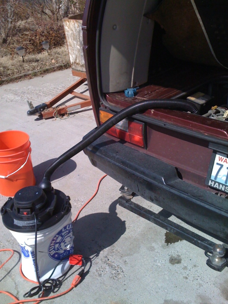

Read up on the shop vac method of sucking out all the coolant. It really works well. A quick search will get you the info. There are loads of ways to re-fill the system, they all work. $400 is a bit steep for a coolant change. Must be some pretty special coolant they use to re-fill it. Me, I am happy with Sierra & distilled water.

Here is a shot of the vac I picked up (buckethead $20 bucks)

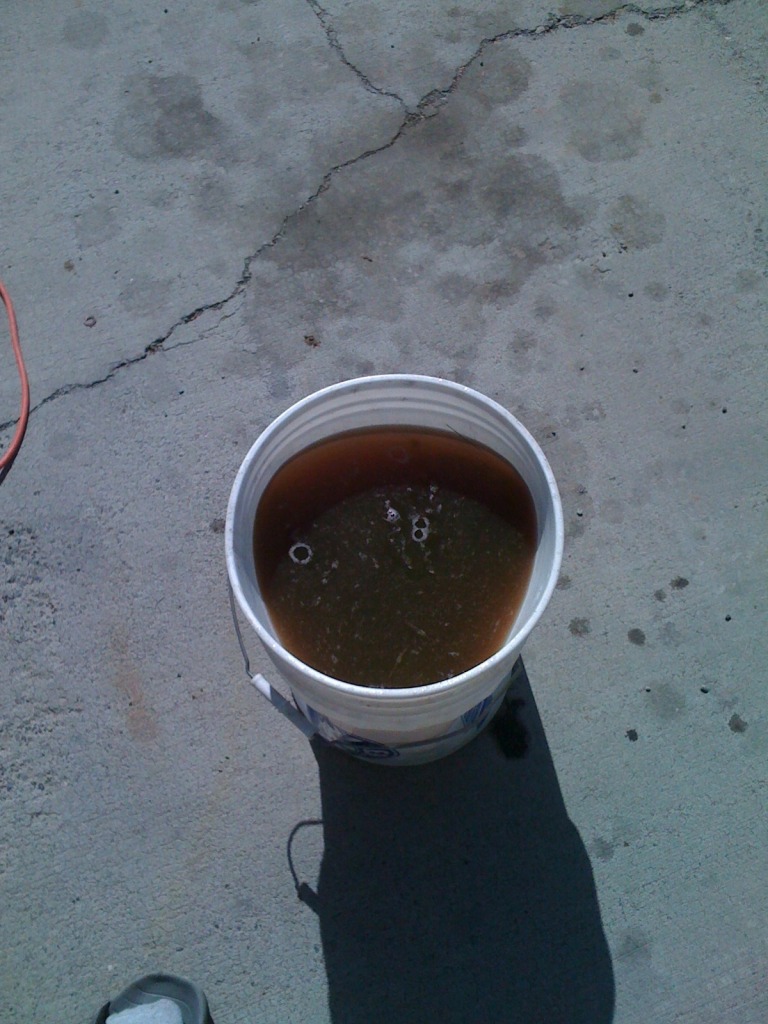

Here is the muck I pulled out (little extra that I added from flushing the resivor too)

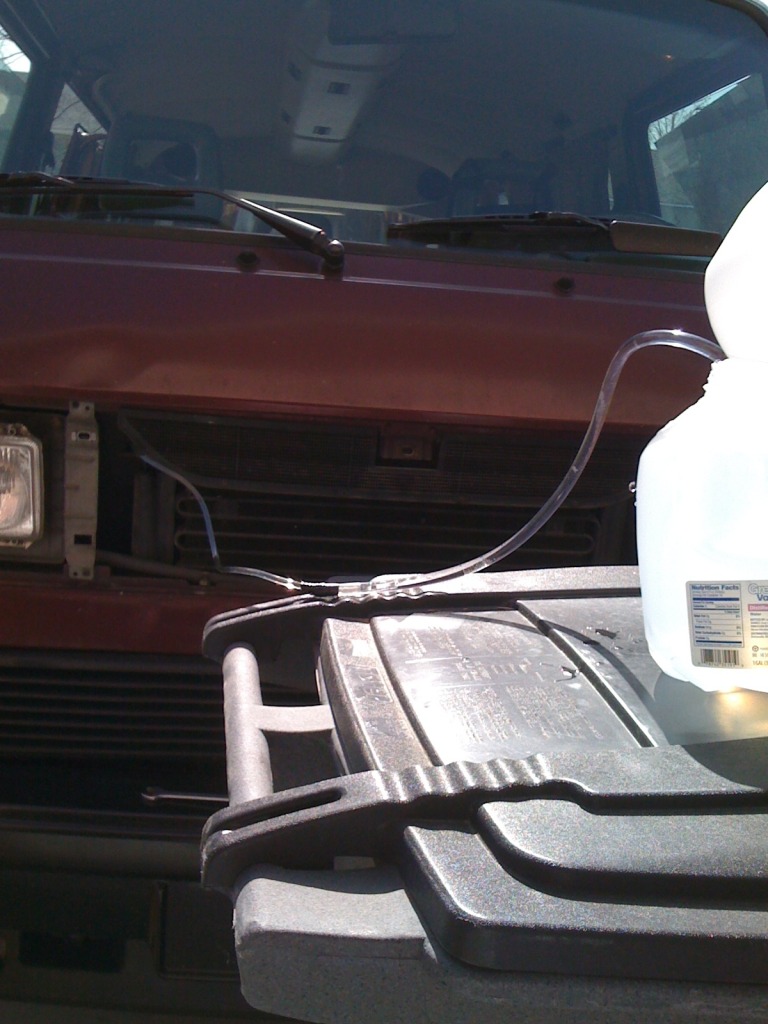

Here is something I thought up(maybe its been done...I dunno) I used some 1/4'' tubing and stuffed it down the breather hole and stuck the other end in a jug of clean distilled water, I sucked about 4 gallons through the system this way.
don't worry, I did refill and bleed and brought it to temp and drained...The first time i did this after suckin all the water through the breather there was barely and color to the water I shopvacced out out...to prevent being flammed I repeated this again...on the 3rd time I refilled bled and brought to temp, bled then used the shopvac on it....and no noticable color.

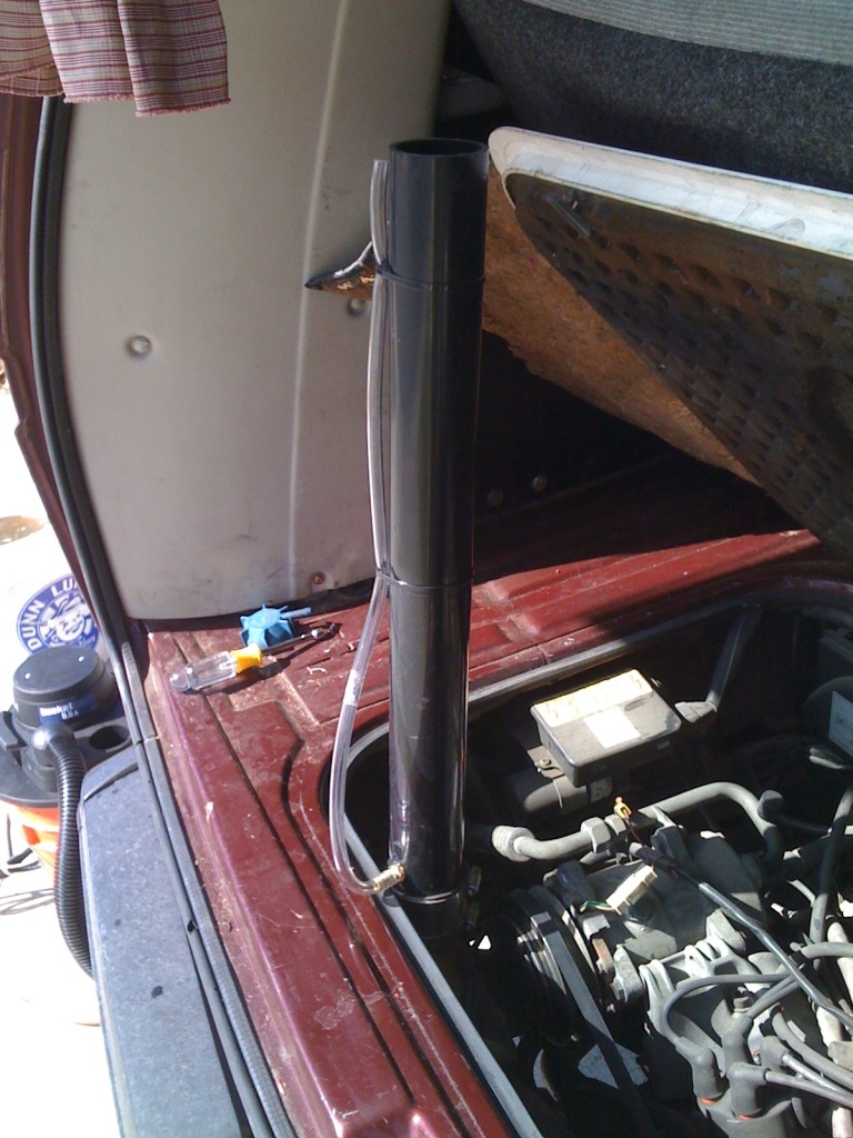

Here its my bong i made to fill the system---I must say this unit is reallly really handy!

Good idea about sucking the distilled through the radiator!

Do you have a parts list and directions on how you made your bong?
I'll be doing my coolant system hoses and pipes in a few weeks and your set-up looks really slick!

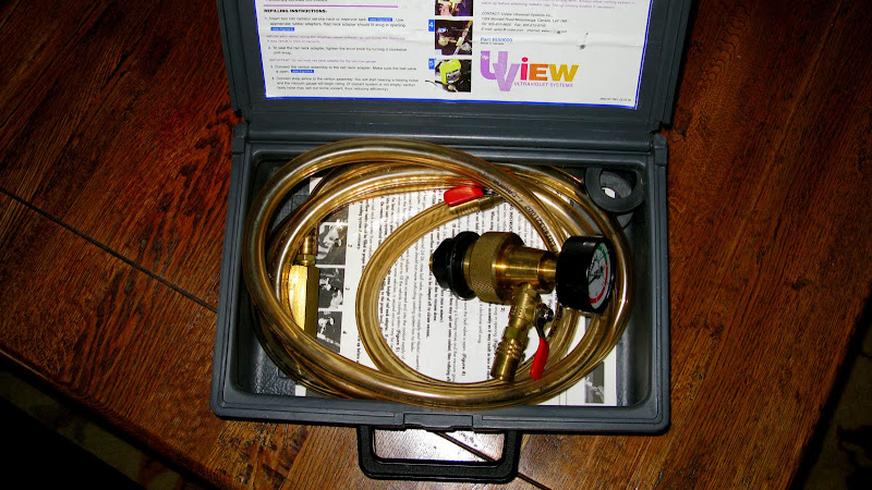

I found this at a pawn shop and I see them for sale once in awhile.
The way it works is it pulls a vacuum on the coolant system you put the end in a bucket full of antifreeze open the valve and it sucks it out in to the coolant system 5 minute job I did not even have to bleed it.

here is what I used to make the bong,
1x 2"x30" black pipe(pre cut piece sold at homedepot)
1x 2" to 1 1/2" rubber reducer with clamps
1x 5/16" brass hose barb
10ft of 5/16" silicone hose, couldn't get any smaller quanity.
cost me $15 bucks to make it, plus it looks cool sitting in my garage.

The brass barb is unnecessary. If you drill the hole with a slightly smaller diameter than the OD of the tubing, then the tubing will seal to the ABS by just pushing it through. That also lets you push enough tubing through so that the end extends below the opening and into the coolant reservoir. That lets you siphon all of the coolant out of the ABS and results in the coolant level being below the opening of the coolant reservoir. When the bong is then removed after draining, there is no spilling.

The tool in Alaric.H's pic is such a great thing to have. Fast and accurate. Back when I worked at a general maintenance shop this was the boss' favorite new toy. Spilling coolant and breathing the fumes all day makes you miserable, and some vehicles would take forever to purge. I would definitely pick one up if I had a nice garage set up.

Klucz and Alaric, what's that tool called? I want one, but my Google-fu is failing me.

PostPosted: Sat Mar 20, 2010 10:24 am    Post subject: Reply with quote
squeegee_boy - 'cooling system service, test and refill tool' should improve your fu. Can't remember the brand of the one we used but it wasn't a cheapo kit.

re: "I used some 1/4'' tubing and stuffed it down the breather hole and stuck the other end in a jug of clean distilled water, I sucked about 4 gallons through the system this way."
- any closeup pics of the insertion point?
- also, would you do it that way again?
