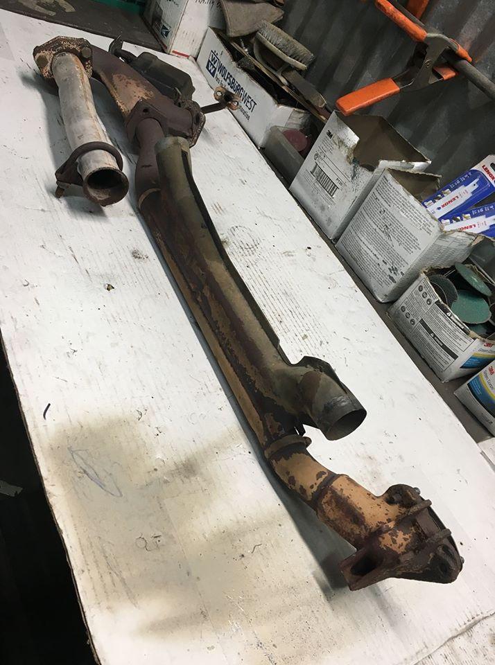

I just recently re finished and reinstalled a transverse crossover pipe for a 75 FI.
