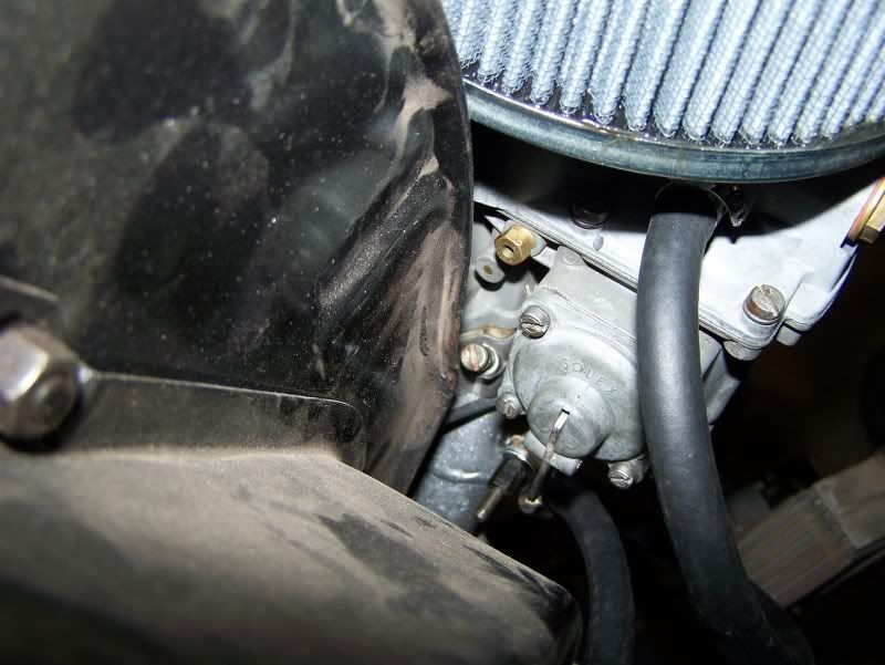

I am running a balance tube on my Kads and can only turn the mixture screw on the 1/2 side as the 3/4 is hidden to close to the upper manifold and shroud due to it not being opposite of the 1/2. How can I set the mixture on the carb or will the balance tube handle it. Any ideas or help. I am about 1.5 turns out, idle around 1050, and the motor runs strong. Once under load it tends to load up in first at 3,200 and beyond. The rest of the gears are fine, until I back off and cruise at 2,000 in 4th and then it stumbles. Any ideas? Timing is around 29 degrees max. advance.

It takes a very long and skinny screwdriver to access the screw, but it can be done once you know how to do it. It is accessed from behind the fan shroud. Here's a photo, looking from behind the shroud:
It is essential that the mixture screw is set properly for your carbs to run right. The balance tube won't take up the slack for poor adjustment.
Hope that helps!
