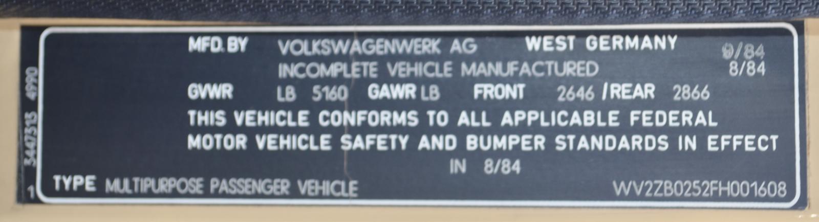

my registration say my Vanagon is 1985. the head lights seem to be 1986. how do I confirm its birth date?

PostPosted: Sat Oct 12, 2019 2:37 pm    Post subject: Re: 1985 or 1986 Westfalia? reg says 1985 Reply with quote
If the 10th digit in the VIN is an F, the van is an '85 that simply had a headlight/grille swap. If the 10th digit is a G, it's an '86.

We need a photo of the build plate on the driver's B pillar. Nice looking van!!

Scott, the pics are nice but do not answer the question... your VIN number is the authoritative way to tell the year. This will appear in at least 4 places on your van as well as on your title.
Easiest VIN to locate should be on a plate visible through your windshield, if you are standing in front of the van it will be in the lower right riveted to your dash. Other spots would be sticker on your b pillar, stamped into the frame cross member approximately underneath the passenger seat, and on the sticker under your dash close to the fuses.

PostPosted: Sun Oct 13, 2019 7:46 pm    Post subject: Re: 1985 or 1986 Westfalia? reg says 1985 Reply with quote
The sticker says engine code DH which is a 1.9. I am pretty sure that LL1M paint was a 1985 only color (best color ever BTW). Over the course of the last 35 years, someone loved this van enough to update the grill and engine from a newer van.

PostPosted: Sun Oct 13, 2019 8:06 pm    Post subject: Re: 1985 or 1986 Westfalia? reg says 1985 Reply with quote
scot marechaux wrote:
Confirmed: Your van is a 1985 model year vehicle (an early '85 at that) and is titled/registered correctly. The van has simply been updated. Wink
