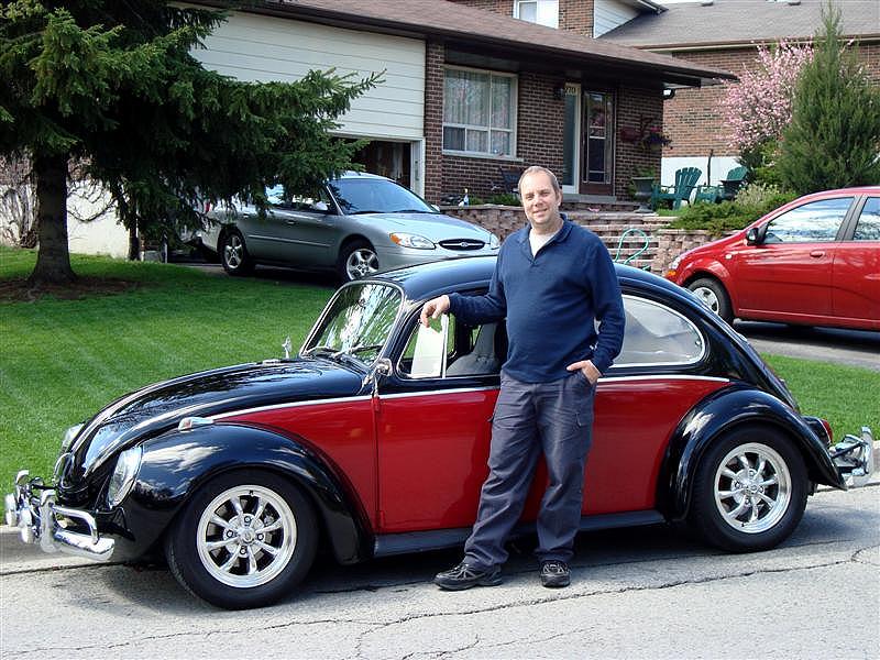

I don't have a pic handy, but I've seen early bumpers on supers. I've only seen one that looked okay. I think the biggest problem when people try to older bumpers on any 68-up beetle is that they don't consider that the earlier bumpers were mounted lower on the car.
Also, the curve of the front of a super looks different than a standard. I think that early bumpers on the front would look odd because of it.

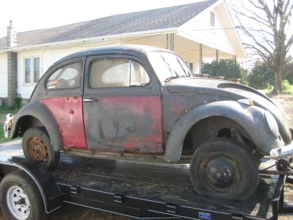

Check it!

Bumpers a little high.

The front ones won't work cause the super beetle ones are bulbous to accommodate the strut suspension. The earlier ones aren't bulbous and are kinda slanted cause of the older headlights.
You can prolly tell the difference from those pics. IMO, the older ones look more like an insect than the new ones lol

partonkevin wrote:
Check it!
Wow, now that one looks good! He did A lot of mods..
