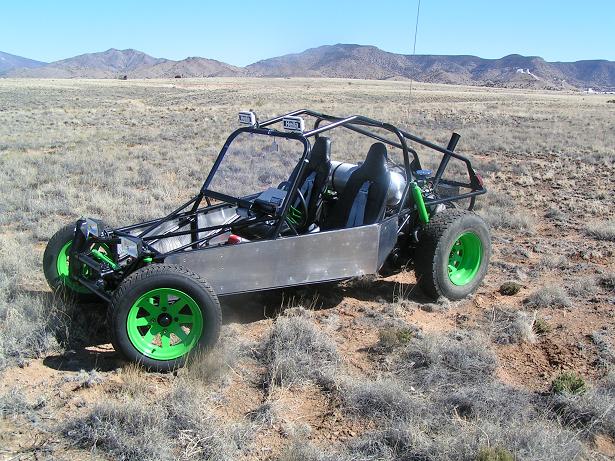

Well, it’s time to come out of the shadows and join in the discussions. A little background: I am in the Air Force, and while stationed at Kirtland AFB in Albuquerque, NM from ’99-‘05 I built a Berrien Warrior. By far one of the most rewarding things I have done. It was kind of a budget build, I was into 4-wheeling a lot and was excited to expand my welding and fabricating skills. So sandrail it was. I was lucky to find that Albuquerque was the right place to make this decision, with abundant supplies of knowledgeable people and parts availability. I bought my knockdown kit from Brandon Buckner of BuggyWorkz in Albuquerque. I then found a donor bug at a local junk yard and got to work. About 6 months later I had it street legal and driving. The off road adventures that followed were memories that I will not soon forget. In late ’04 I received orders to Eglin AFB, Florida and the sandrail sadly had to go. A wonderful family in Roswell, NM were the proud new owners, and off to Florida my family and I went. So, about 5 months ago I was digging through my old e-mail address and what did I find? The e-mail address of the family in Roswell with my beloved sandrail. I instantly desired a drive in the dirt behind the wheel and decided to send them a quick e-mail to see how it was doing. After I found out it had been sitting for quite a while, the urge to get it back and rebuild it was almost uncontrollable. About two weeks later, my son, brother, and I were on the road, trailer in tow, to Roswell to get my sandrail back. The family that had it was amazing and I was very grateful, and before I knew it, she was back in my garage just asking to be rebuilt. I was able to put about a month of work into it before I was sent where I currently am, deployed to Afghanistan. I don’t have much longer here, and I have a pile of new parts waiting for me when I get back. I have been gathering a lot of really good ideas from this website, and it’s members seem to have an amazing amount of knowledge. So I have attached some pictures of the original build from ’04 and some pictures of the current rebuild. Any tips or pointers are always welcomed.

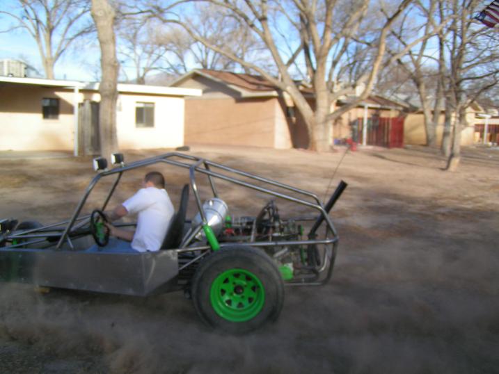

A test drive in the back yard before teardown and paint.

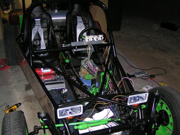

Wiring, yah!

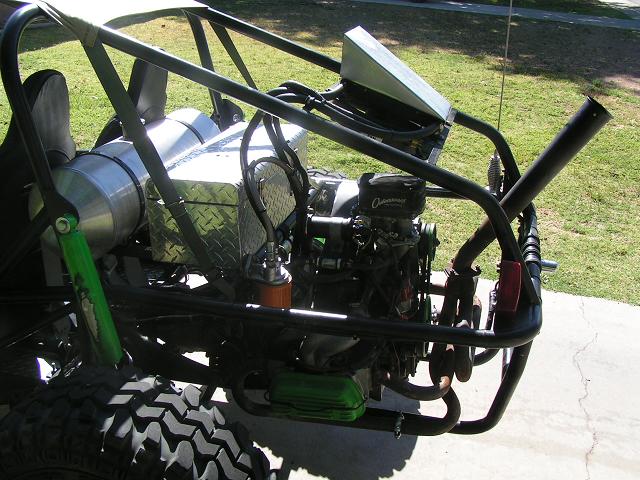

Engine resealed, carb rebuilt, all cleaned up and ready.
Wiring harness repaired

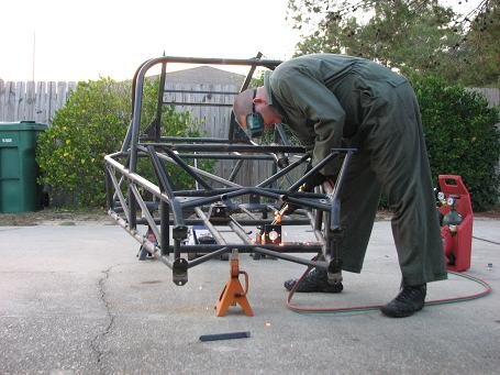

While you got it apart I'd brace the frame some. I think you may agree after reading this: http://www.thesamba.com/vw/forum/viewtopic.php?t=354795&highlight=lost+friend

Thanks for the link about frame bracing, I think I will see what I can do to mine to strenghten it. I have to admit though, I am usually pretty mild off-road, I try not to get into many situations that will cause a roll. But not too many people actually plan on rollovers, and you can never play it too safe!

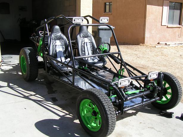

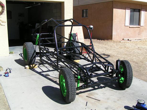

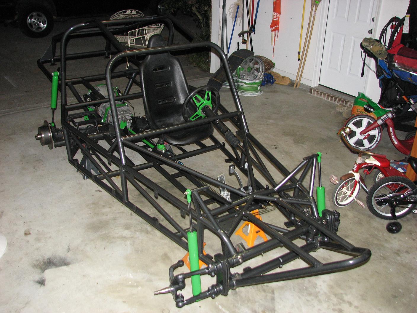

Blasted and ready for prep and paint.
Primed
Painted, went with Rustoleum Black Hammer Finish in the rattle cans, turned out pretty good, I am happy with it.
Close up of the hammer finish

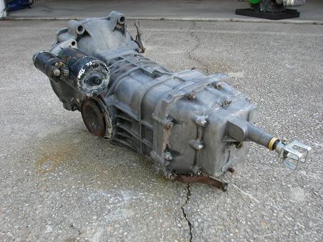

Starter rebuilt, slave installed, tranny ready to go.
Suspension parts ready
Coming together

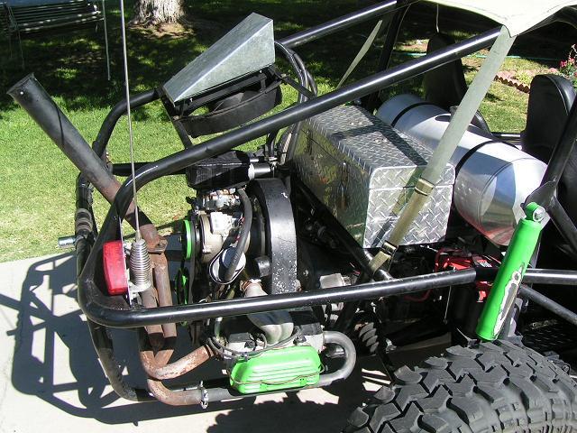

Not sure how I am going to run the throttle cable yet, I have a Morse Cable on my workbench but I am not sure how I am going to run it so that it is not right next to my foot. Any ideas or pics of yall's setup will be welcomed.

Don't have a picture handy, but I tan my Morse cable between my feet, and under a raised heel/footrest on/above the floor. I had to utilize one of the higher holes in my throttle arm to get full sweep for the throttle activation.
