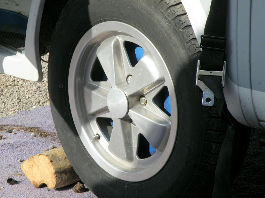

PostPosted: Thu Jun 13, 2013 9:06 am    Post subject: had these for a year Reply with quote
I haven't had a chance to pull these yet but wanted to know if anybody recognizes this set up??[img]
[img]
some days I get up and just sit and think. Some days I just sit.
opinion untempered by fact is ignorance.
Don't step in any!
