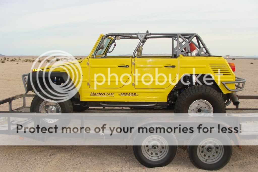

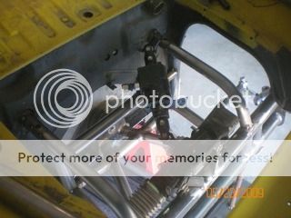

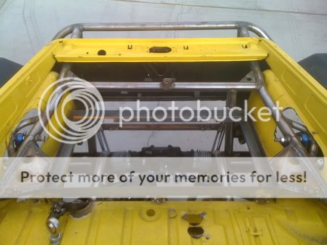

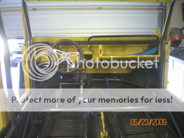

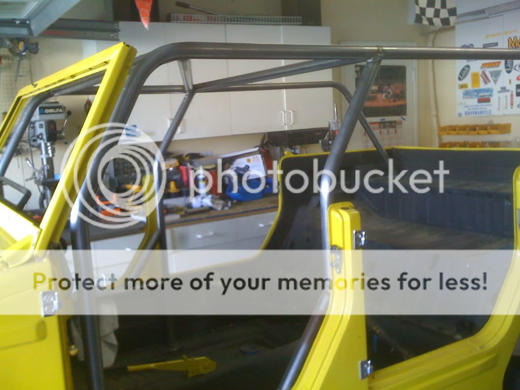

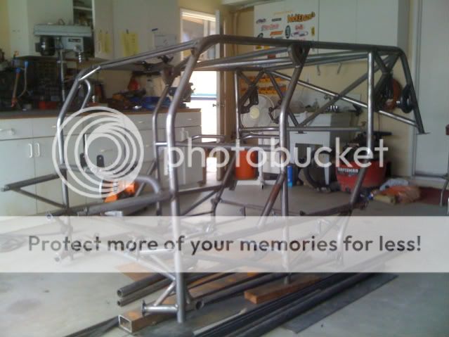

punchdrunk monkey
Joined: December 23, 2006
Posts: 145
Location: Poway, CA
punchdrunk monkey is offline
PostPosted: Tue May 11, 2010 6:42 am    Post subject: Reply with quote
Thanks Locky!

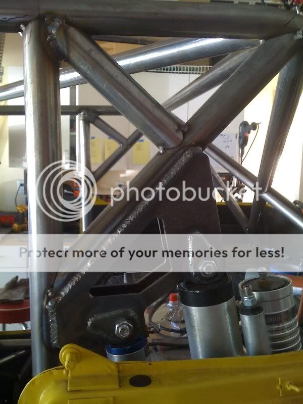

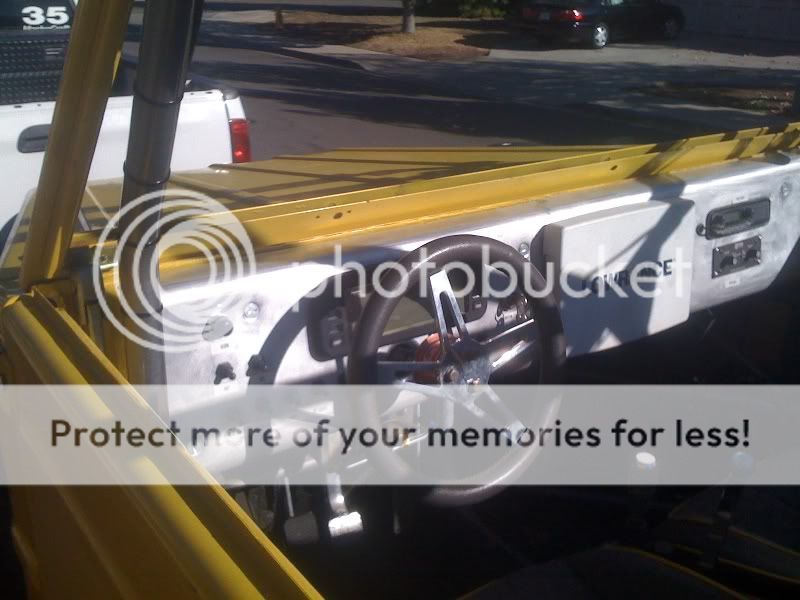

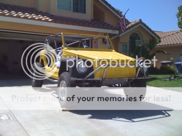

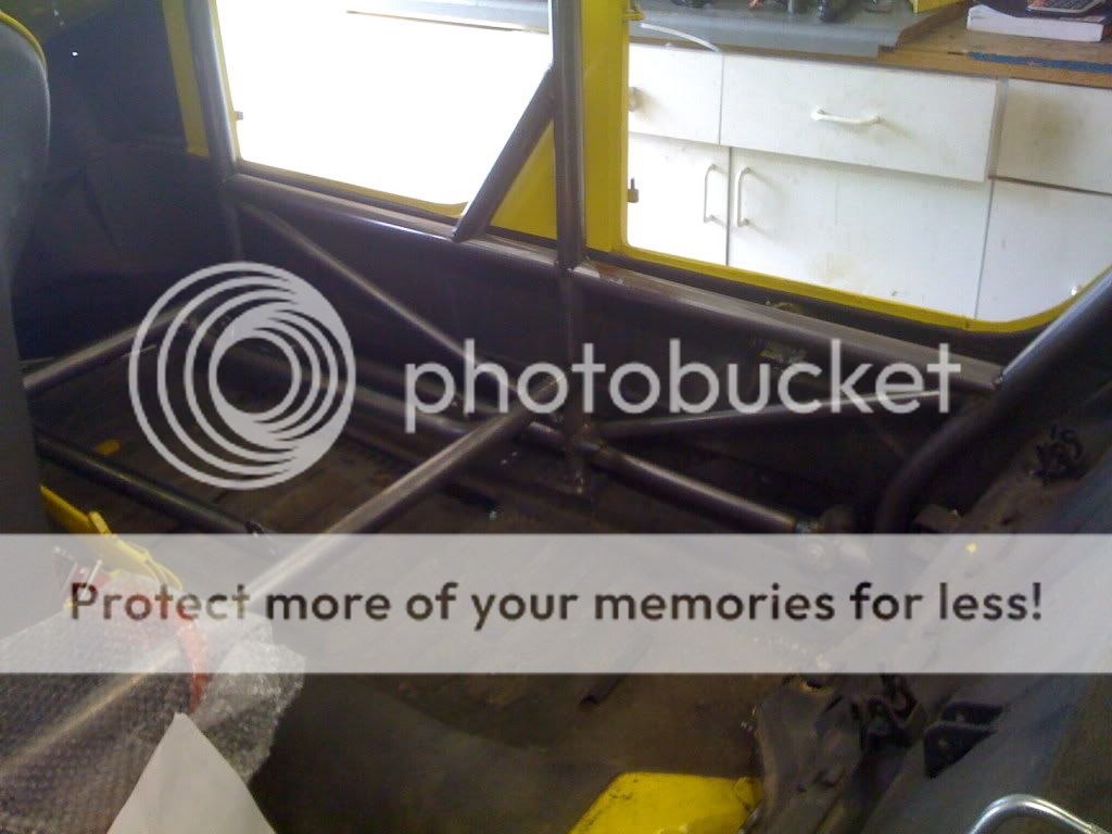

I never posted to many pictures of mine here due to "it shouldn't be here, it should be in the off-road section". Now that my gripe is over......My cage was not built to incorporate at top and I don't have stock seat belts. But here are a few pictures that might help with ideas.
The start of the main cage
Lower door bracing
Front area before dash
Power steering and rack mount
Front bumper
Rear bumper
Upper shock mounts
Front radiator mount and front shock mounts
Cage removed for final welding and painting
Dash
Profile before rear fenders were made
With rear fenders.
