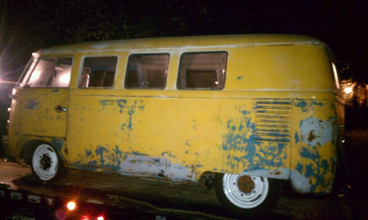

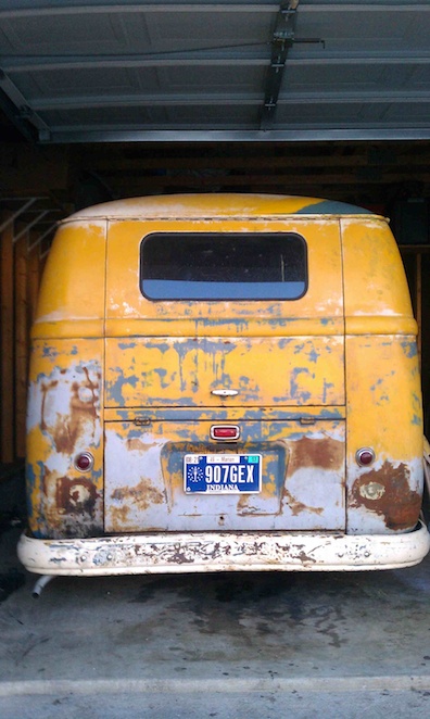

PostPosted: Fri Feb 04, 2011 10:27 pm    Post subject: The night I bought it... Reply with quote
on it's way to my garage.

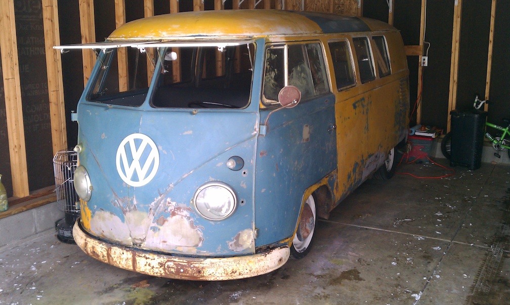

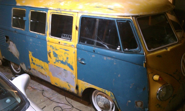

PostPosted: Fri Feb 04, 2011 10:29 pm    Post subject: removing paint... Reply with quote
Easy Off, Scotch pad and 2 hours got me down to this. Easy Off works great, a little slow, but that is probably better so it doesn't go after the OG paint as bad. The only issues are the corners and tight spots that you really need to go slow at so you don't get past the OG paint.

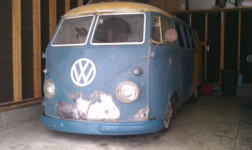

PostPosted: Fri Feb 04, 2011 10:31 pm    Post subject: exhaust work... Reply with quote
Fri Dec 10, 2010 11:39 pm
Went back with a stock exhaust...runs much quieter and heat is working great in these 8 degree temps. I wanted to put the rear bumper back on and the aftermarket exhaust didn't allow for it. Looks a ton better with the exhaust all tucked away and OG bumper back on. Working on getting all of that aftermarket paint off this winter...BIG project when it's cold. Dove blue paint underneath looks amazing though.

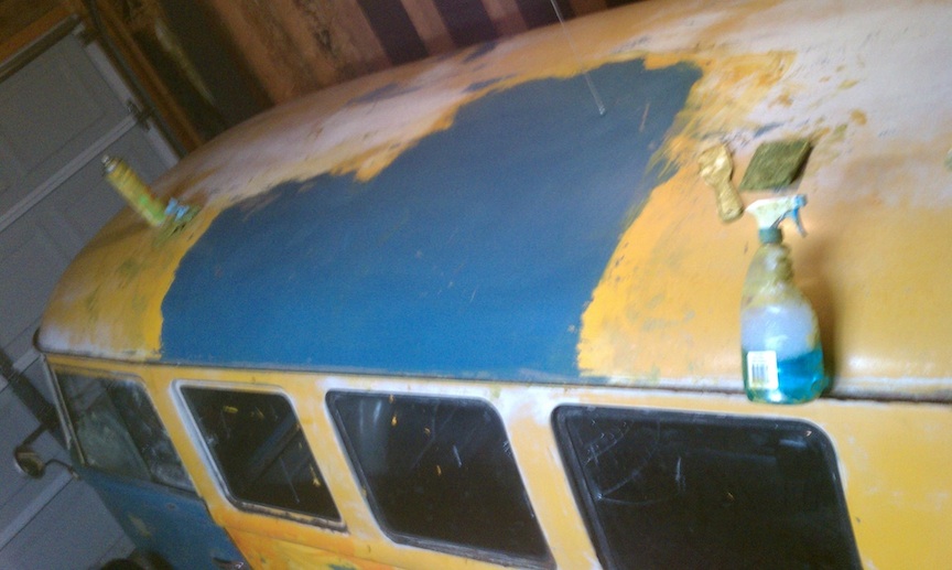

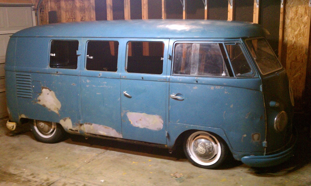

PostPosted: Fri Feb 04, 2011 10:35 pm    Post subject: removing paint... Reply with quote
Found a new trick today for working in the cold weather. I put a kerosene heater inside the bus and it heated the roof up a little over 100 degrees. Add Easy Off...scrape...wipe clean. This section took me only 30 minutes. I'm thinking I'm going to start using a heat gun as well.

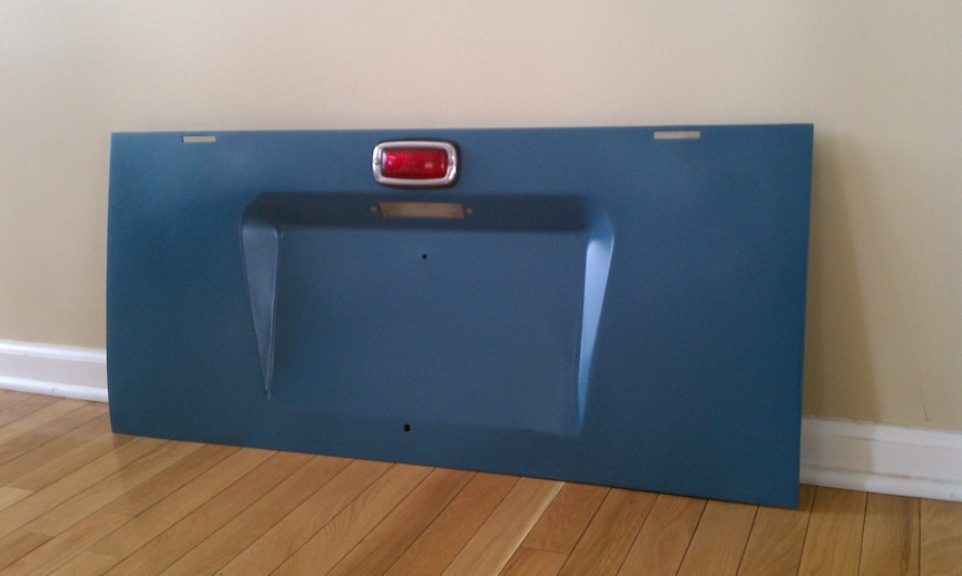

PostPosted: Fri Feb 04, 2011 10:39 pm    Post subject: removing paint... Reply with quote
back end done with decklid back in...That rear bumper is sticking out pretty bad now. I need to get it straightened. Not sure if Mark Rafferty is still doing that?
