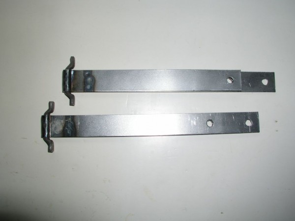

You were correct Bengt, the round pin was retrofitted.
I'm angry at myself of just cutting the 2 perfectly good flat door stops when getting my splitted split car...
But perhaps one can make such a flat stop? I don't have any of the pieces left... Sad All fell apart... Pics?

PostPosted: Mon May 03, 2010 1:19 pm    Post subject: Reply with quote
Do you mean these?

PostPosted: Mon May 03, 2010 1:39 pm    Post subject: Reply with quote
Thanks!
probably are those, but as I cut them I don't know how they should look...
I'm searching for the split 50/51 door check straps...
If you could make me a "drawing" I would be very happy! Smile I.e. with, length and thickness...
If I have luck, some of the parts are still left inside the doors, but as there are no bottom part of the door the chanses are slim... If I remember there were some squary piece somewhere too...

PostPosted: Mon May 03, 2010 1:48 pm    Post subject: Reply with quote
i can send you a door check. you can copy it and return it afterward?
i'll get a pic soon
