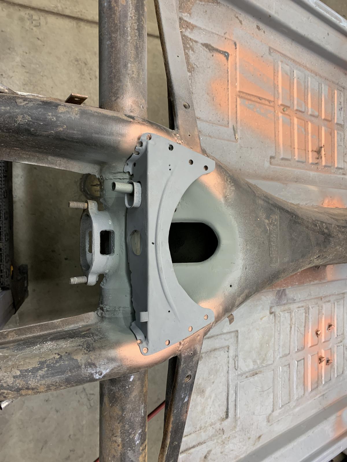

Last week was the first time i pulled my 36hp engine, & among other things I noticed is there is no accel tube coming from the body to the engine. All there is a long fuel line tube - so it looks. and only went about a foot.
I am betting it was not designed like this, and would now explain why the accel tube going thru the fan shroud was hose-clamped right behind the shroud.
Have had the car ~ 15 years and the accel system worked fine, except letting off the gas, the carb return would not go all the way so was at a slightly fast idle.. Not sure if it is related to the fuel line tube or not.
If there was a metal tube coming from the body, how was it anchored there.?
Thanks!

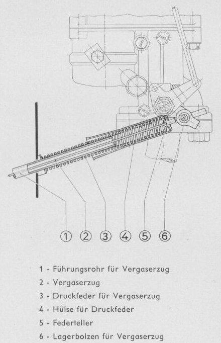

Is this what you are after?
Page 31 of my gallery has a few more! Hope it helps.

There is no tube connecting the chassis to the body. The cable pokes out this seal in the back of the chassis where the cable exits and goes through the tube that sticks through the fan shroud.

The spring and little round keeper (5) holds it tight.

You also need the sleeve that fits over the spring. the little round keeper Nancy speaks of is held in place between the sleeve and throttle lever. and the Bowden tube has nothing to do with what you are talking about. Clutch cable goes through that.
