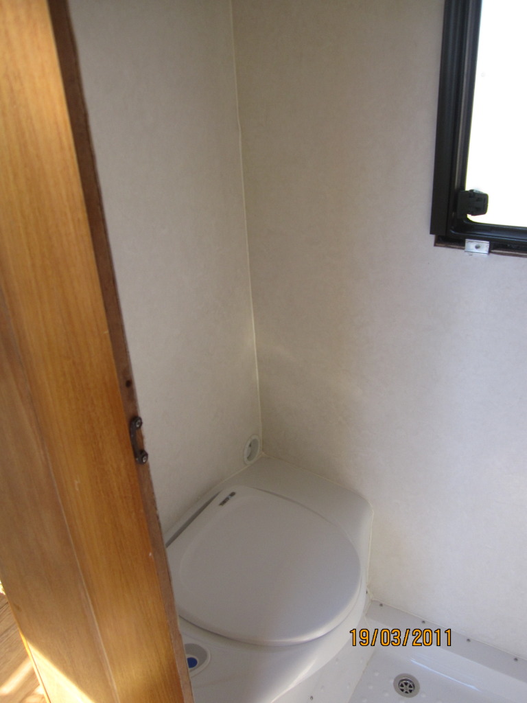

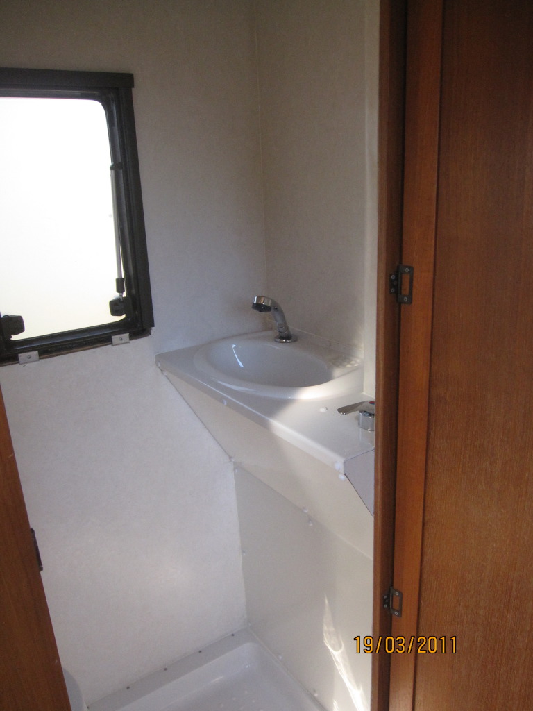

So, ya really want a shower? How about a toilet too? Oh the luxury...these are from the Karmann Gipsy/Cheetah forums where I hang out lately, after buying one of these rigs. Someday the bath in mine will look so nice...
