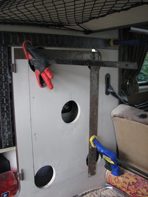

I must first give credit where it's due. Mootpoint posted this one a couple years ago: http://www.thesamba.com/vw/forum/viewtopic.php?t=264050&highlight=closet
After admiring the functionality of this for sometime, and finally working up the courage through several of his pep-talks, I finally cut into the cabinet wall. It's really not as difficult as it might seem, and anyone with basic woodworking skills can accomplish this in an afternoon.
Used a 4" hole saw for the corners, and the finest tooth jigsaw blade I could find.

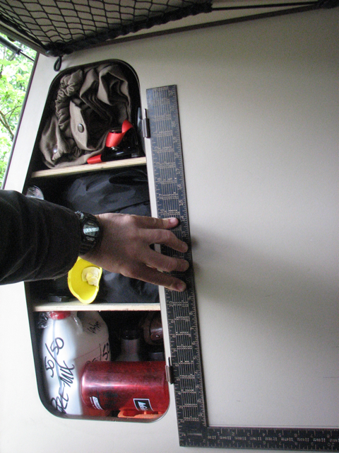

My initial measurements were to determine how much depth was in the closet, and where I wanted the door. I needed to clear the GW shoulder belt and I wanted the door to open 90* with the seat back up. Once determined, I used a right angle ruler to draw out my left vertical and bottom lines using the rearmost cabinet opening as my guide.
I had the frame from the donor, so used this as a template for drawing out the cut lines. Then it's time to drill out the corners.
Make certain to clear the cabinet before drilling/cutting.
The point of no return. This is the first of the four corners to be drilled out. The center hole was simply practice.
I used the right angle rulers as both a guide and to keep the jigsaw level during cutting. Likely not the best method, but it worked.
The hole! Shocked
Routed out the slot for the T-molding using a Freud 63-104 router bit. LOTS of dust. A bit of glue in the resulting slot, and tapped the original T-molding right in.
The finished project - works exactly as intended and looks like it came from Westfalia this way. The only thing I'll add is a couple more mesh pockets like seen on the back wall to the inside of the door for convenient storage.

Unfortunately it's not that easy. The hinges are a two piece design that relies on gravity to keep the door in place. Flipped to the other side and the door would simply fall off.
The hinges off of the left-swinging lower door by the bench seat would work, everything else in the van swings to the right. It must be a political thing. Laughing
The hinges on the door side are also riveted in, a different design altogether from the cabinet side. Those would need to be drilled out and replaced as well.
