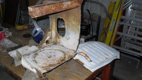

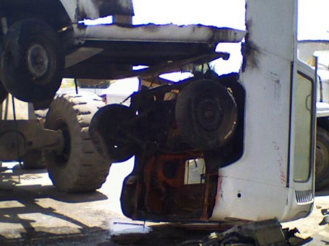

I love Bays!!!....for their sheet metal
My treasure chest is rotted so I'm going to make a new floor out of this bay's. It was on it's way to the crusher about 500 ft away

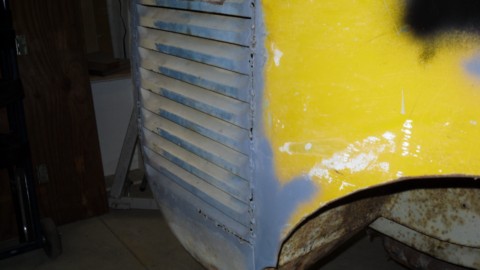

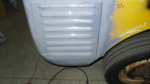

Pass Corner:
Wow, I can't describe how much I couldn't wait to fix this thing. I had to fab up the seam tyhat someone welded over. After welding, the seam pulled a little due to shrinking. The pics show this and I plan on fixing it. I welded the seam together on the middle of the backside of the lip. In hindsight, if you are not using an actual spotweld gun, the welds need to be closer to the inside of the seam so they cant pull apart as easy...

Got this clip for free, cant complain, thx Mark!
The clip is still caked with paint and bondo, so the pics are decieving. Hit it with primer to look at it in one color.

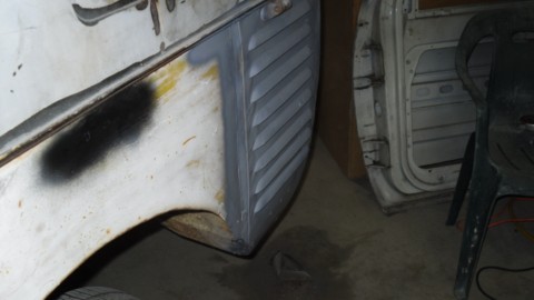

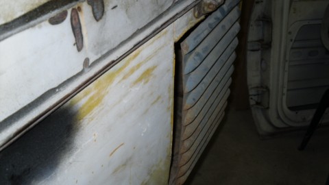

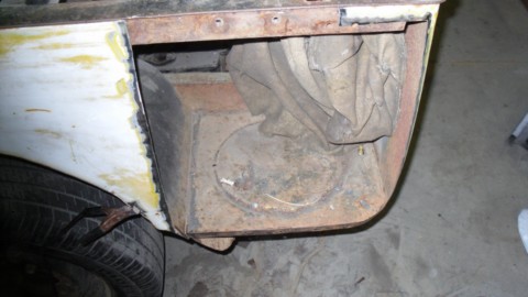

Driver Corner:
Thank god no one attempted to weld this regular bus vent in. This clip I got from a samba member and cut it off myself. Got the seam for this one!

PostPosted: Sun Jun 27, 2010 12:02 pm    Post subject: Reply with quote
Some shrinkage at the welds, but a low spot is better than wavy high warped spots..

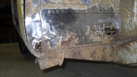

For those that think this is just a dry California piece of cake...
TinCanFab
Joined: April 04, 2006
Posts: 2743
Location: Waterford, California
TinCanFab is offline

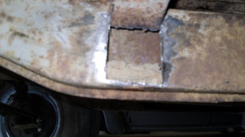

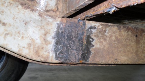

PostPosted: Sun Jun 27, 2010 12:11 pm    Post subject: Reply with quote
Amazingly, the jack supports are great, all outriggers are wasted. I have all new ones and a new frame crossmember. The top hat filled with water for many years inside the treasure chest rot, and ate sideways thru both main framerails. All pitted frame areas are getting patched before the new outriggers go in. The pass inner main frame rail has a hole that was hidden by the outrigger the size of a quarter. Just goes to show you that the front floors are not the only thing that indicates rust. Probably had nice window and door rubber, but salty Chicago roads?

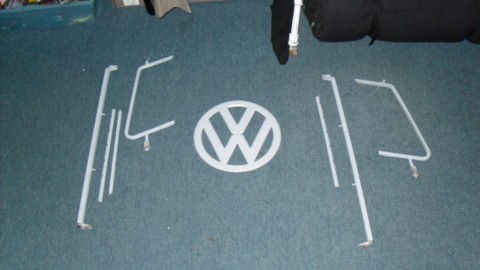

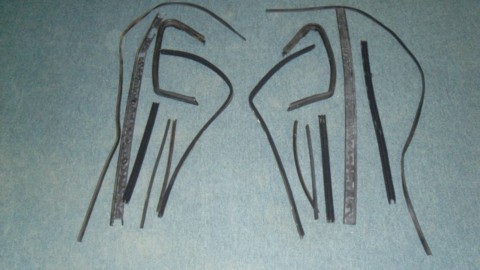

Windows:
Did these in the house while watching the tube and listening to tunes. Emblem is silver white and window parts are light grey
I never want to do a set of these again! What a pain

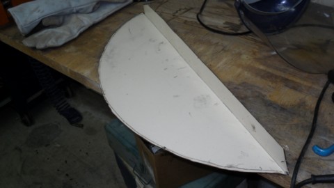

PostPosted: Sun Jun 27, 2010 12:22 pm    Post subject: Reply with quote

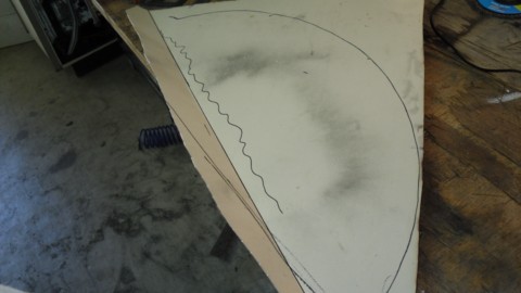

I found a great way to recycle used appliances! Found a dishwasher behind my new house and chopped the sides out of it....
