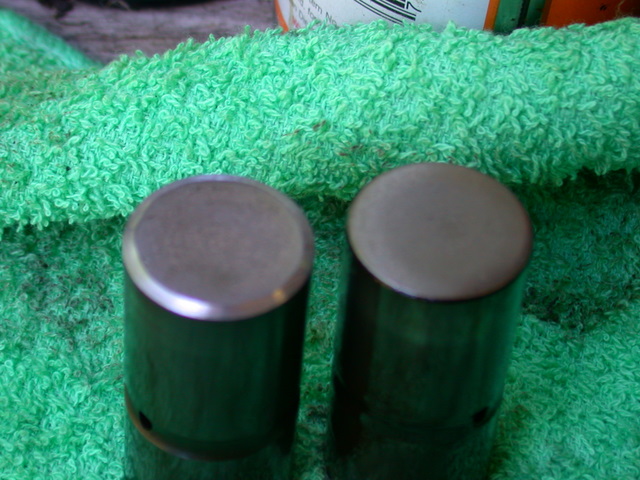

With the tubes out I pull each lifter and have a look see. They really don't look to bad, but are worn down to where the chamfer around the face is about gone and experience tells me that cam wear will soon be accelerating if I don't do anything. What I do is regrind the chamfer with my bench grinder. I grind it at about 20-25° to the face verses the original 45ish degrees, assuming it will cut into the cam lobe less at this lower angle.
If the heads have sharp edges in the pushrod tube bores, I round those edges with a round file so that the o-ring will not be cut when the tubes are pushed back into place. On this particular head the bores had be remachined for some previous owner and were nice and rounded, so no filing was necessary.

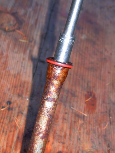

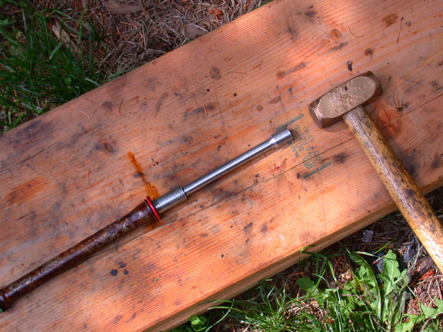

To install the tubes I build up this set up, a stepped 1/2 drive socket that will wedge itself pretty tightly into the large ends of the tubes.
Using this tool I can typically install the tube in just a couple of seconds using a twisting motion as I push in on the tube.
Removing and reinstalling the tubes is pretty easy doing it this way. I wish I had an easy way to clean all the gunk off the engine. Lots of elbow grease seems to be required no matter what kind of stuff I spray on there.

I have never in my life seen chamfered lifters in a 411/412.....at least nothing like that.
Most have a .020" to .030" max 45* bevel at the edge, but not a chamfer protruding into the contact area. Ray

The chamfer is what I cut into a used lifter. As you are well aware T4 lifters and cams get a very funky wear pattern with age. It has been my experience that they run and wear fairly evenly for the first 100K miles or so and then begin to really dig at each other, cutting a groove in the center of the cam lobe and dishing the lifter badly, sometimes even leaving a weird little tit in the center of the lifter. The idea of recutting a chamfer at a lesser angle is to prevent the lifter from gouging the lope so badly. Even though there was the tiniest bit of the original chamfer left, the rim where the face and chamfer meets had a very sharp burr, I hope to reduce that burr and the cutting of the lopes by recutting the chamfer. I did this to my high mileage 1800 many years ago now and it still runs well at 225K, though I haven't pulled a lifter to look at it.
Don't know much of anything about the history of this particular engine. Way dirtier than you would expect for an engine out of a passenger car, and it has obviously been seeping oil for a long time. Lots of varnish built up inside the engine, but it doesn't look like it has been too badly over heated. The valves were all set correctly when I first pulled the covers and from the crud level it was obvious the covers hadn't been off in a while.
I have hope this engine may have a lot of life left in it and will have been worth the effort to clean up and reseal.

Another thing I do to make dealing with this job easier is to insert 1/4 inch diameter bolts into the holes in the rocker shafts while I have the rockers off the engine. Keeps the all the pieces of the rockers from falling a part and getting intermingled with other stuff in the parts bucket.
Here is the much cleaner engine with all the tubes installed.

Ah...yes....that chamfer would cut down on the center divot. I know exactly the ragged ....sharp edge on the lifter scenario you are speaking of.
But also what I have found....is that only "some" of the type 4's wore to leave a ragged edge on the lifters. I just don't know the rhyme or reason. They will all wear that divot in the center just due to the flat face, tapered lobe and offset contact.
But.....I have had factory engines that got the ragged lifter edge syndrome at moderate to high miles....and others that ran really high miles but never wore the ragged sharp edge on the lifters.
But what I did also find is the on those that did wear the lifter edge ragged....replacing the lifters with even new OEM's....also wore the new lifters ragged in a relative short time.
This is why a few years back when everyone...owners, builders, Jake, Webcam and others really started talking about the wear issues ...and failures with type 4 lifters.....I kind of confirmed my suspicion that here were differences in hardening and geometry over the years.
That heavy chamfer trick might very well give some added life to an engine before actually needing to tear it down, clean out the metal and put in a properly matched cam and lifters. Ray
My idea has been that keeping with the used matched lifters should cut down on this kind of rapid wear. Don't have much of a sampling to choose from with regrinding the chamfer, but I have done this to a hand full of engines over the last two decades and have had no bad reports.

I do know that my last web # 73...with Johnson lifters.....did fantastic. Not a mark or divot on it or ragged edge of lifters in 89k miles......and it all died from an oil pump nut that came loose Crying or Very sad ....but the cam is still pristine. Ray

If you have access to a valve grinder, a better idea is to resurface the lifter with a slight convex surface, just like new ones. But nothing beats a new cam and lifters.

I think that is a yes and no answer. Doing it the way I did means the lifters are still matched to their lobe so there should be no break in wear, but you are still dealing with an "old" lifter with a slightly concave wear pattern. If you do a convex grind you will be dealing with an essentially new lifter which will have to rebreak in the cam. Which is best? Not sure, but as I can do the one at home and am sure it works I will probably stick with it for now.
