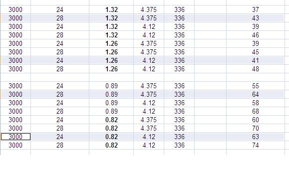

I just put some HUGE tires (7.00x15) on the rear of my 60 to see if the rebuilt bus center section (4.12 r&p with .82 4th) would be worth the swap with my 1600cc DP.
here is the comparison between my stock 4.37 trans and the 4.12 bus
pretty close but the bus trans spread between 3rd and 4th is a bit further than Id like.
Engine is a fresh rebuild using all OEM parts.

Ive been testing this combo for a month now and logged temps and mpg on my daily 150 mile commute (reason for considering the FF).
Previous log showed the following temps at 60mph running stock 165 tires:
CHT 250-300
Oil temp 190
Oil pressure 35
MPG 26
I am sad about the mpg but I drive with CRAZY winds both coming and going throwing the bug all over the place so I am sure this is affecting the mpg. Previously in SoCal I would get 29 plus mpg on the same setup.
With the larger tires and at 65mph the following temps were noted:
CHT 300-350
Oil temp 200
Oil pressure 30
MPG 27
The increase in speed and mpg was nice but the increased temps and sluggish performance on ANY grade was disappointing. Around town the CHT stayed at 250 and oil temp below 180, but I also rarely shifted into 4th.
I agree with previous postings which say 100hp minimum is required to pull the taller gears with out the increased temps.

PostPosted: Mon Oct 04, 2010 8:48 pm    Post subject: Reply with quote
More data to post on the FF in a beetle.
I installed the smaller 356 pulley to see how much more cooling it offers.
Average head temps dropped 30 degrees while oil temps dropped 40!!! I have to drive at 75 mph for longer than 30 minutes to get the oil up to operating temperature.
At 55mph head temps dropped 50 degrees
At 65mph head temps dropped 30 degrees
At 70mph head temps dropped 15 degrees
Oil temp drop was stedy at 40 degrees at speeds below 70mph, at speeds above 70 the temp slowly rose but never passed 185 degrees. At speeds below 70 the oil temp was only around 130 degrees. I dont like oil temps lower than 180 as the moisture does not evaporated from the oil and the dreaded "milk shake" foam in the oil filler will soon develop. In SoCal I never had this problem but now up here I feel this will be a problem.
