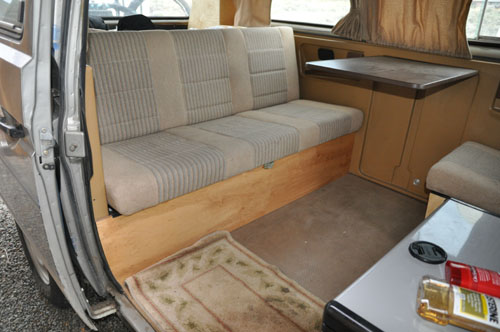

I have an '87 Wolfsburg. Think weekender with no pop-top and no rear cabinet. I have pulled out the passenger side jump seat and removed the latch mech. and seat belt. It gives me a lot of room for moving around the cabin and a cooler sits right nice there.
I have often thought of building a cabinet with sink on top, small fridge underneath and a "pop-up table" accessible with the sliding door open to sit a coleman burner on. I would make it removable also so I don't lose the space while daily driving. The one you linked to looked nice but at over $1000 plus shipping! Shocked
You could probably take a design to a custom cabinet maker here in the states and have it made for less if you are not handy with a multitude of saws. Good luck.

Here's a few things I have done on my latest van to gain some space in a weekender:
