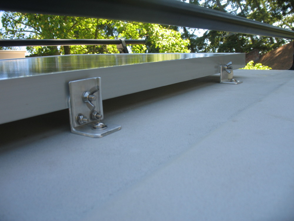

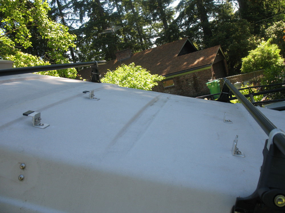

FWIW, I followed the quick release lead of GW when I rigged mine, a 65w Kyocera panel. I fashioned some quick release hardware for the roof, and a 50' extension cord from 12-2 landscape wire, and some connectors a friend gave me that are from the RV/trailer world.
The front rail of the panel secures snugly under the rubber padded, forward facing aluminum roof mount tabs, while the stainless steel bolts (tapped and screwed thru the rear rail of the panel) slide through the aft mounts, secured with a split washer and wingnut. I wanted some redundancy; even if a wingnut came off, I think the panel would probably stay put because of the way the tabs engage the front rail. I added rubber feet to the bottom of the panel to:
1. avoid damaging panel or poptop
2. allow clearance for the underside j-box of the panel
3. slight compression when fitting under front tabs so everything stays snug.
Slightly exacting getting the tolerances just right, there is some height adjustability in the rooftop tabs. Now that it is done it is very fast to set up, has not required adjustment, and has yet to become loose in any way. Took a bit o' figuring so maybe this might help someone else too. I bet there is a more elegant solution but I used what I had available.
The 12-2 landscape wire fits easily right out the driver door, doesn't get pinched when closed, and is sufficient for the length run and power of this system.
We liked the options for roof use, tripod use, and easy stowing for security when needed.

teej wrote:
Looking at all possible ways to route the
wires before I actually do this.
And I can relate to the trepidation drilling those roof holes:
Looks like our tent (1986) is getting tired. . .
teej, thanks for this - I think I'm going to do exactly the same with my 135w Kyocera. I'm getting tired of stowing it in the bunk and taking it out each trip. I've been trying to figure out a solution and have also looked at the GoWesty mounting setup. Too bad they don't sell it separate from their kit. Makes business sense, I guess.
Not sure if you wrote down all of the parts and sizes, but if you did, I'd really appreciate the specs. Thanks again.
