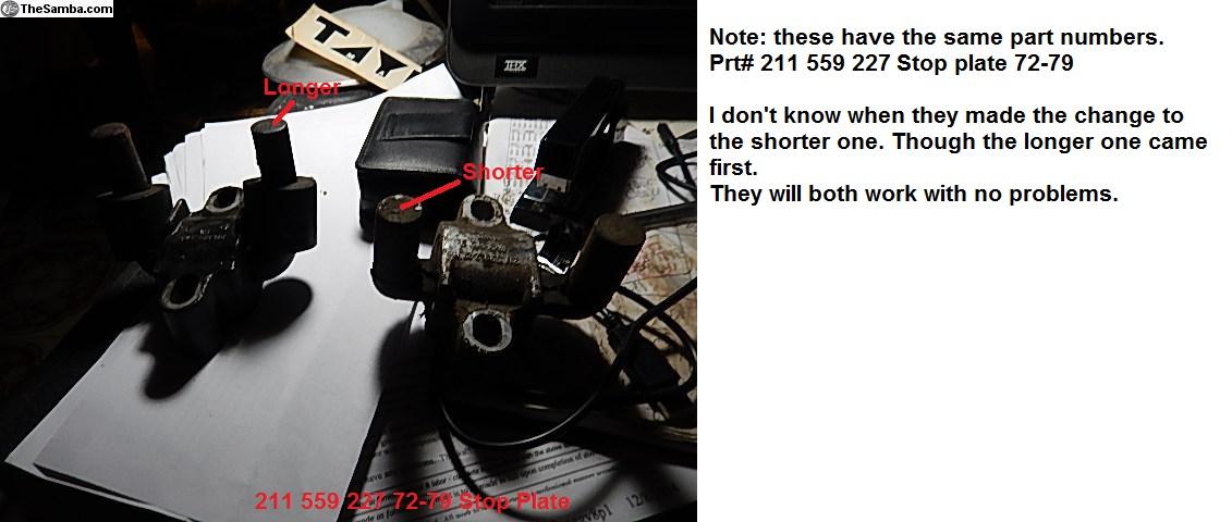

PostPosted: Sat Nov 08, 2014 9:40 am    Post subject: 211 599 227 Stop bracket/ Front Trans mount Reply with quote
Hi
There are two different one's. But either will work.
Notice the mounting bars are different. The first one has the reliefs machined out for the Stop Bushings. Either will work.
72-79 bus mounts 2
Thanks to jerseylooker!
