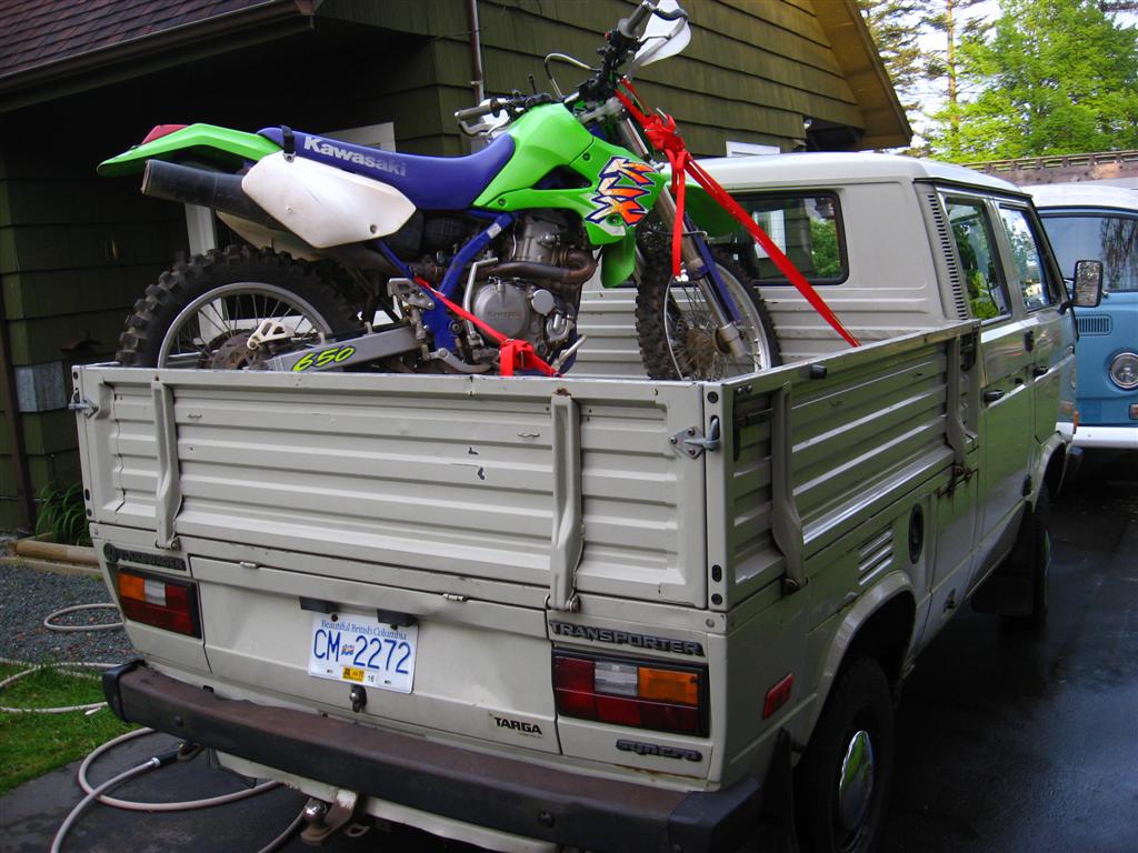

I got it all loaded...had to cheat a bit and put truck down a bit of an incline to lower the height but walked it up the ramps and loaded it up myself!
I think I will add the chains as mentioned above and add a couple tie downs where the rear latches are (longer bolt with a eyelet added).

bit off topic, but is that a canadian spec doka?

Do you have pics of the ramps you used and in particular how you secured them to the truck bed before loading ?

Yes indeed, it was bought right here in the town I live (Campbell River) in '86 but not by me.

I'll take some some pics when I unload this weekend and post them up. They are basically ramp ends from a FLAPS with 2x8's, then attached some extruded aluminium mesh for grip. I made the 2x8's about 90" long so they reduce the angle as much as possible and still lay diagonally in the box on edge under the bike. The ramp ends sit on the inside of the rear gate (dropped down) and have a couple steel pins to drop in which will not allow it to slide back.
Up front I got the Mercedes Sprinter hold downs from a local Chrysler dealership and have the bike's bar's attached there with straps. One side of the rear of the bike is attached to the step on the rear gate (I know it is riveted...I am kind of taking my chances). Soon I will find a longer bolt for the rear latch then attach an eyelet on the inside of the box off this.
