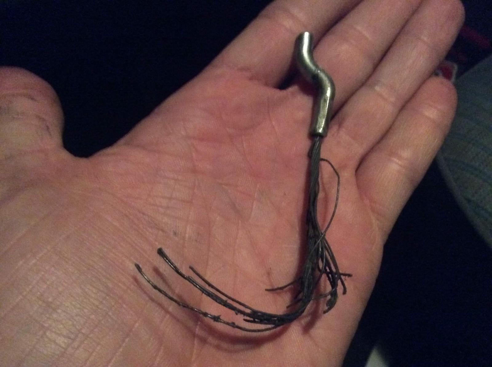

Hi all.
For those who don't know, there's a cable + spring in each pop top strut that assists lifting. Or as I found, assists lowering. One of mine failed on the last 1/4 of lowering. Top suddenly "fell". No not really literally, but pop top weight suddenly increased. I was caught off guard. Coulda really hurt my head. ( I can live w/o that right? Wink )
The cable is NLA from VW. It has a swaged type "Z" fitting. (thoughts toward other solutions below) I can borrow a crimper, but can't find the swaged "Z" fitting. And, it seems that my thoughts toward drilling out the plug on other end of cable, pushing the cable through and crimping on a stopper to the end, may not work. Possibly not enough room between new end of cable and pivot pin.
Anyone know of a totally reliable way to make a cable? If not....
If I go with the Jack Bombay lift kit, I figured I'd disarm the other good cable. That way the lift strength is set up for that "weight" with nothing but the struts (edit: gas cartridges) to (eventually) fade away.
Any users out there with both sides (cable/springs) broken using the Jack Bombay lift assist setup?
Thanks!
Neil.
(leg looks too small.... would have to be pushed through from under, then wire crimped on... I think. From here:
http://tinyurl.com/2avsmwd
Bolt to hole on strut and bend? From here: http://tinyurl.com/29kxquj

I'm curious what thickness that cable is. I have cable and I have the swage fittings, about 1/8"dia. Got them from a local Princess Auto in Canada. You have a similar outlet in many areas of the US. Harbour Freight comes to mind, and there is another large one that sells by internet and post.
I never use a swaging tool, just vise grip type pliers tightened progressively as the swage flattens.
A marine shop in North Vancouver said they would let me "borrow" their crimper (bigass thing) They would direct me, but work has to be by my own hand for liability reasons.
The OEM cable is ~ 2mm. So like 1/16". I'm going with 3/32". Oddly though, the OEM cable feels stiffer than the thicker aircraft cable I bought.
I'll check Princess thanks.
This part http://www.westernmarine.com/acrobat/blu190025.pdf (PN 190025) might work but I'm pretty sure it should be bent to follow curve of part on lower arm where cable wraps around. And.... it would require a bolt through to hold it in place. The spring is pretty thick gauge and strong. Not sure how much stress would be put on parts when compressing the spring (top down).
Just thinkin' out loud. Smile

Vanagon nut - for that "z" piece, with a small lathe and steel rod, couldn't it be possible to drill out a hole in the end to suit the cable?
Then crimp it on with a vice, punches or the like.
Then with a vice and hammer, or arbour press, put the 'z' kink in it?
As for the other end, I am not familiar with what it looks like.
Maybe I just like a challenge, but I'd be trying to make a replacement if, or when, mine goes like yours Twisted Evil

I like a challenge too, but part of the goal was to find an "off the shelf" solution. Hours of googling and some leg work later, there remains one slight stumbling block: the other end of the cable. Even though a possible solution was arrived at today (swage with ball and hollow bolt) as far as I can see, using a modified stock part or different parts, there likely isn't enough room between that end of cable and pivot pin on base. i.e. when pop top up, the spring expands and these parts would bump up against the pivot pin. Yes a coil or two could be cut off spring, but considering all the changes to the original design, ..... not what I'd do.
Re: Z piece. The part is only about 4mm OD. Not hard to shape I bet. One might be wise to heat the part to be shaped first. Even then, I'm guessing one has to be certain that they have the ID correct for swaging purposes. Sure yah it could be made, but ......
With all due respect, Smile a hand made Z, or modded rigging part or a through bolt and eyelet type end on wire rope, may not ensure that all is 100%. When the one side failed, it really caught me off guard. If my hand had been in the way, it might've gotten caught, or, my head could've gotten a good bonking. It just about literally fell the last bit. I would hazard a guess that the failure would likely only happen when closing the top (compressing spring, tensioning wire rope). Sure just about everything will fail if used long enough and not maintained. Problem with this part, is can be really "out of sight, out of mind".
And again, with all due respect, if someone was to do this, I'd suggest using a proper swage tool to secure the ends to the wire rope. (cable).
I just see something like the Jack Bombay assist as a better idea. Uses what I assume are commonly available parts and is easier to get at. Besides, when the cartridges start to fail, I'm pretty sure they give obvious signs much like failing hatch struts.
Whew! (sorry didn't mean to write that much!)
Neil.
pic of spring and functioning cable shown below.

Ok. So Mr. Spitsnrovers got me going. Wink
If you choose to make and/or use this part, you do so at your own risk.
Here's what I see as being one possible solution. I don't feel like taking my pop top struts apart AGAIN. Wink So some of this is guesstimating.
The thimble (part inside loop) might be a bit too long causing cable where it exits the ferrule (the crimp on part) to be bent at a small angle. This is because it may go around curve instead of flat bit of arm (see previous pic) AFAIK, the cable shouldn't bend where it enters or exits a fitting. (termination) But..... guy at yacht place that did the swage ball, suggested this may not be an issue in this case as the angle would likely be small. Bottom line: the original part failed, and 29 years from now, the part shown may well fail. Wink Still, I'd prefer to use a cable bushing (picture a small pulley) at this end. The distance from arm face to stop pin (pin that stops the motion of struts once top is up) is ~ 11mm. The height of thimble, washer and bolt head will hopefully be less and will clear the pin when top pushed up. BTW, as seen in another members post, these parts wear. I repaired mine so it's dang close to original. The 11 mm I roughly measured MAY NOT APPLY to your struts. They may be quite worn.
Other end is a bolt I ground down (no lathe!) and drilled a hole through. The shank of swage ball end fits into this hole. I will counter sink bolt head where ball seats. And even though the cable should be a straight pull through the spring, I will counter sink or chamfer hole where cable exits. I may push some silicone through too. The stock piece might be useable in the same fashion, but I'd be curious to know just how much the strength of the end would be compromised by countersink. I cut a coil off the spring and ground end "level" to allow for the longer bolt head/ball combo. The head on the factory part is ~ 4.3 mm. There is ~ 4 mm between head on factory part (no coil cut) and pin that secures strut to lower hinge bracket. Cutting a coil off gave me an added ~ 10 mm clearance IIRC.
To secure upper end, I'd likely run a bolt through hole where Z was. There appears to be room on the other side of this hole for a nylon locking nut.
It is crucial that this nut/bolt stay put!
If total length of cable/terminations is right, even when top up, there is slight tension on the spring. I assume it was originally designed that way so Z wouldn't come out of hole. With that said, I would try to get the new assembly length as close to OEM as I could.
I did a dry run of supporting pop top with post. Top was lowered slightly onto post. This took weight off the struts. Once done, it's possible to take apart the arm WITHOUT the cable.
DO NOT TAKE APART ARM WITH CABLE. Even though when top up, the spring is barely compressed, it just wouldn't be wise to do so.
Parts are all SS - 3/32". The cable (wire rope actually) is slightly larger than what I removed. The shop used 7x19 wire. Ball on end is a shingle shank swage ball. Google will show you the way on that one. This part ABSOLUTELY has to be swaged on and the ferrule ABSOLUTELY has to be installed with the right tool. A cable wire (wire rope) shop or marine rigging shop will help you with this.
I asked dealership recently about this part. It's NLA, but was listed at ~ $45 Cnd. Parts cost for mine was around $20. The swage charge being $10 per.
The swage was done by someone who knows what he's doing. I may go back and get him to crimp the ferrule. We'll see.
My apologies for all the upper case. Just want to be clear. Hope all this helps. If someone else needs this part, they would be well served to measure everything. At the very least, this post should save the next person some time Googling and such.

mortengrau
Joined: July 03, 2020
Posts: 2
mortengrau is offline
PostPosted: Fri Jul 03, 2020 11:56 am    Post subject: Re: PopTop Cable Broke. Made new one. Link to pics. Reply with quote
Facing the same problem on my T4 today, ten years after this post, I have been able to track down the “z” strut - almost...... Smile
Probably not of use for you guys, but maybe it’ll be a help for someone outthere in the future.
When I showed the worn down end to my mechanic, he immediately said: “brake wire”. I turns out that Westfalia (maybe) have just used original VW Transporter brake cables, and then moderated them to fit into their lifting bar spring assisted system.
I have not been able to track down where to get that cable (if it’s at all possible), but at least I found the “z-end”. Maybe someone can design a DIY from that info....? 🤞
[/img]
Vanagon Nut
Joined: February 08, 2008
Posts: 10522
Location: Sunshine Coast B.C.
Vanagon Nut is offline
PostPosted: Fri Jul 03, 2020 1:14 pm    Post subject: Re: PopTop Cable Broke. Made new one. Link to pics. Reply with quote
Nice find!
As a guess, if one could find a length of steel that would accept a new cable, maybe bend it to "Z" shape then have it properly swaged on to new cable?
I've done a fair amount of camping trips on this bus in the last 10 years or so. I recently had the pop top arms apart. I didn't see any obvious wear at the cable especially where it exits the crimped piece holding the loop at fastener to arm.
Here's a link that should take people to my image gallery of all this
https://photos.google.com/share/AF1QipMaxVOiB8PaJh...1kNzJ5d0R3
Neil.

mortengrau
Posts: 2
PostPosted: Sat Jul 04, 2020 3:01 am    Post subject: Re: PopTop Cable Broke. Made new one. Link to pics. Reply with quote
You’re welcome Very Happy
BONUS: The ‘z’ is called a “dog leg wire end” or wire stop:
https://www.google.com/search?q=dog+leg+wire+end&a...&hl=da
foodeater
Joined: July 13, 2007
Posts: 1318
Location: Newburgh, NY
foodeater is offline
PostPosted: Sat Jul 04, 2020 7:59 am    Post subject: Re: PopTop Cable Broke. Made new one. Link to pics. Reply with quote
It looks like a lawn mower throttle cable might work as a replacement for this. Assuming you can find the right length.
https://www.walmart.com/ip/183281-Replacement-Brak...gIPr_D_BwE
and you would still need to crimp on the correct fitting on the end.
Perhaps a small engine repair place it where to loo for the dog leg end.
