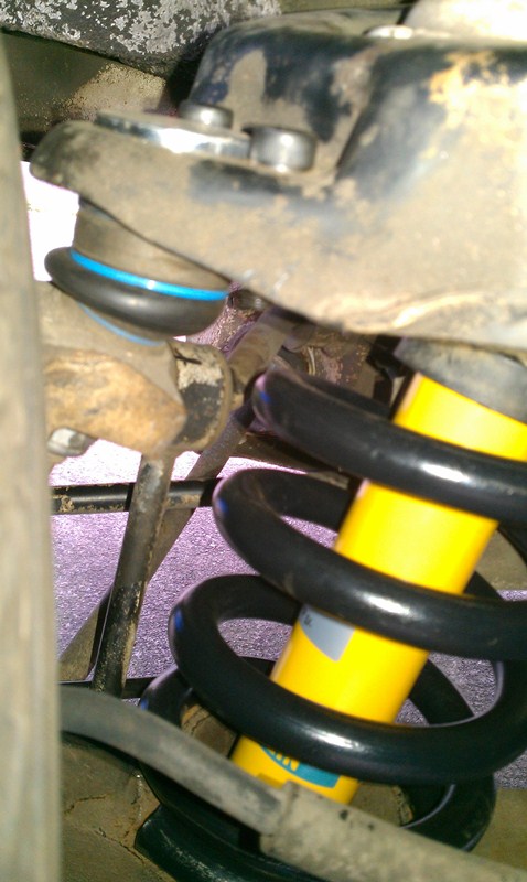

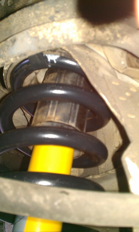

PostPosted: Sun May 20, 2012 9:02 am    Post subject: Update: NAPA 277-3175 Front Spring Install Reply with quote
Well I finally was able to install my NAPA 277-3175 springs, $80 for the pair. I had a few other projects to finish up (like a Subaru 2.5 install, etc.!). The springs work great! My strategy of using electrical tape to keep the upper rubber isolator on during install worked perfectly. I used an internal spring compressor to ease the install, checked out from O'reilly auto parts, so no cost if you don't have one. I'm not sure you could get the spring in and seated without one. I added upper ball joint spacers from GoWesty. My front height is now 18" exactly. I also installed Bilsteins all around while I was at it. Now I just need spacers in the rear to bring everything level, and new tires to go with my Van Cafe steelies. The ride is nice, while not being too stiff. No more nose dive on braking. Sorry no during pictures, but here's some shots after. Looks like it belongs there!
[/img][/b]
Joe Vanagon
1990 Carat with EJ25 SOHC

PostPosted: Sun May 20, 2012 11:12 am    Post subject: Reply with quote
Before getting to crazy with spacers, drive it around for 3 months to let the springs and shocks settle in. Then you'll be able to level it better.
