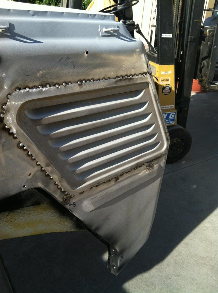

With the body, the passenger side rear quarter was bad enough that I had to source a OEM replacement, which turned out to be from a 73. So now I have a set of vents for the passenger side and a gaping hole for a hamster cheek on the diver's side. Rolling Eyes The dilemma was do I cut the 73 vents or source another panel with vents for the driver's side. I always liked the look of 73 over the 74, so I was able to find some driver side vents from a yard in Texas that I am going to plug in.

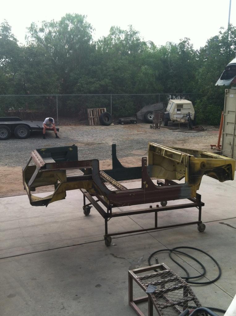

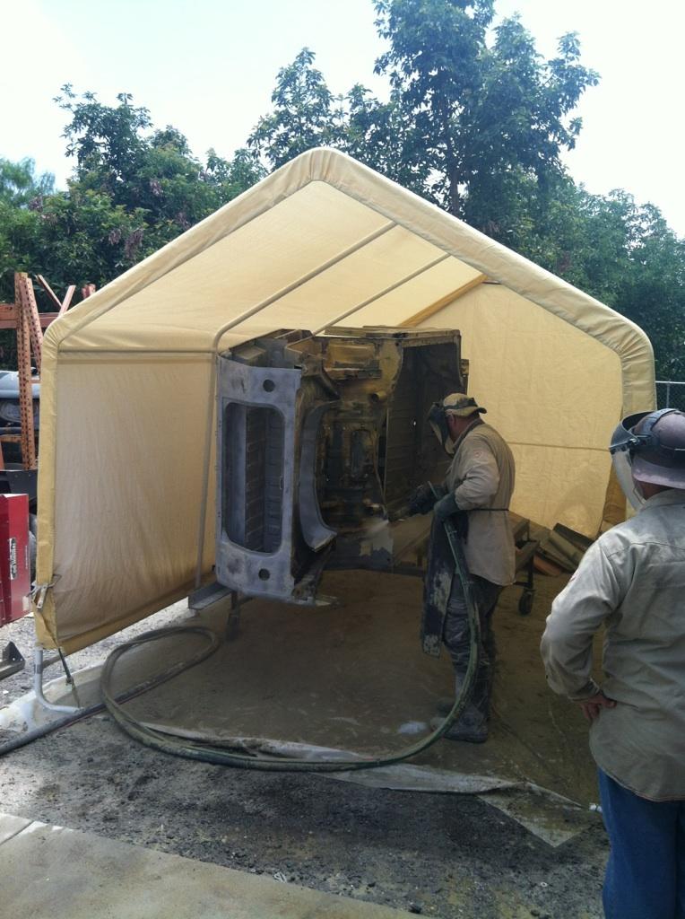

So we finally resume with a little progress! I decided to go with water blasting instead of sand or soda or chemical dipping to remove the rust. Here is where we started:
Water blasting does include some glass media, but the lack of heat prevents any warpage of the metal
Turning the Thing on its side revealed a left over treat from the factory that was previously locked in the channel above the deck lid
And the end result: Very Happy

Here is the dustless blaster we used: http://dustlessblasting.com/new2013/
Overall I am very happy with the results. They use a rust inhibitor in the mix and the rinse that gives you 72 hours to prime it. Cost wise for the whole body, all of the fenders, doors, decklid, hood and bumper ran me $600. The quotes I got for regular sandblasting were around $800; soda blasting was $1,400 and chemical dipping was $1,800. Rolling Eyes The price was even better taking into account the dude came to my buddy's shop and cleaned up the media afterwards. Very Happy

Now a "wannabe" 73 Laughing

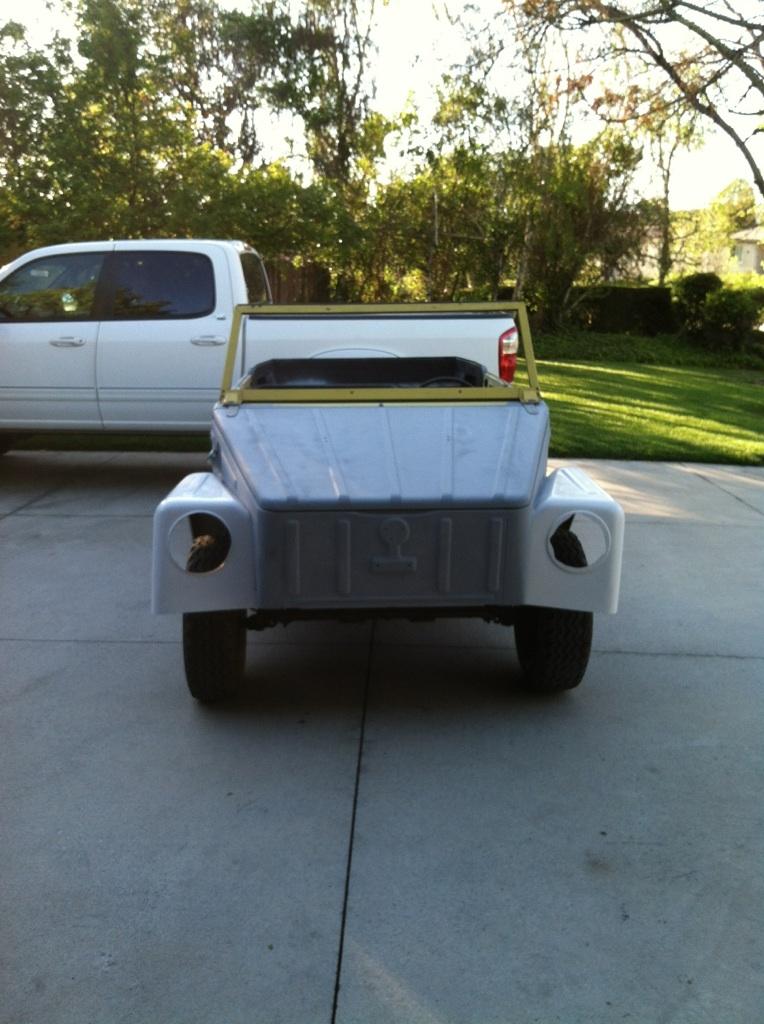

The off road Thing is coming along. Body work is 95% done. I picked up a set of fenders from Brian Coats Fabrication in Huntington Beach. I'm going to add a set of stock headlight buckets and run stock lights with the headlight rings instead of the Bugpack lights. The quality of the fenders is outstanding!
I like the 2" raise and lack of turn signal bumps:

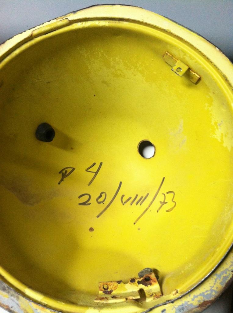

Working on the buckets tonight, I'm wondering if the pen markings are original? Made on the 20th of August, 1973?
Ron Domeck
Joined: August 05, 2007
Posts: 1466
Location: louisville Ky
Ron Domeck is offline
PostPosted: Tue Apr 08, 2014 9:49 am    Post subject: Reply with quote
I have found these markings o a few. Also found the same type under the gas tank on the fire wall panel on the right side.

Had the same markings in mine...
I debated on trying to keep them when I was doing the restoration, but decided in the long run that saving the fender was more important Smile
