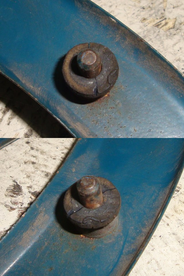

PostPosted: Sat Oct 31, 2009 5:04 pm    Post subject: Reply with quote
Could somebody post up a pic or two of what the original seals looked like. I need to put the OG paint one that I just got on my bus and I wanted to get it right the first time before I put those impossibe to remove clips on.

Posts: 71477
PostPosted: Sun Nov 01, 2009 6:16 pm    Post subject: Reply with quote
12 mm diameter
2 mm thick
