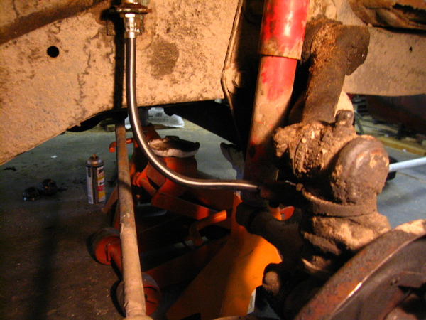

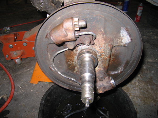

My 62 Double has had brake trouble since I got it. Seemed there were alot of new parts under there, and most of the time it stopped fine, yet still at times it would pull left. Then sometimes it would pull right. It was getting to be downright dangerous. Then last week I noticed a drip from the right front wheel....
So after reading as much info on the forums as I could I decided against an expensive disc conversion and fixed what I had. I think I spent about $150 to fix or replace everything on the front wheels.
Some pics if your interested
Stripped and ready for the new parts.
I rebuilt the wheel cylinders
New rubber lines

keep an eye on your rear wheel cylinders, with the increased pressure in the system from the front replacement, the next weakest link is likely to start seeping
