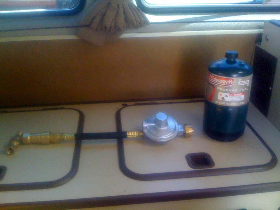

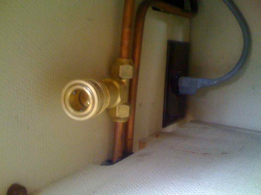

I have a working quick connect under my sink
in my case it was meant to allow me to connect a 1 pound, or larger, Propane tank to the Westy, to keep the stove and fridge going..
you can see the quick connect in this picture (before I installed it), attached to its supply line
I spent 80 bucks on all the hose and hardware, including the regulator that you dont need for your application..

Thanks Jon, that's helpful. Great idea too, one installation, and it gives the ability to feed accessories off the main tank, or run the primary camper functions off an auxiliary tank. That may be exactly what i do!
All common hardware store parts?

the parts I used were from a Propane company, Ferrelgas in Santa FE, NM, that also sells BBQ supplies.
The quick connect is all off the shelf stuff, except they built the hose to my length requirement.. try asking an RV supply outlet..
