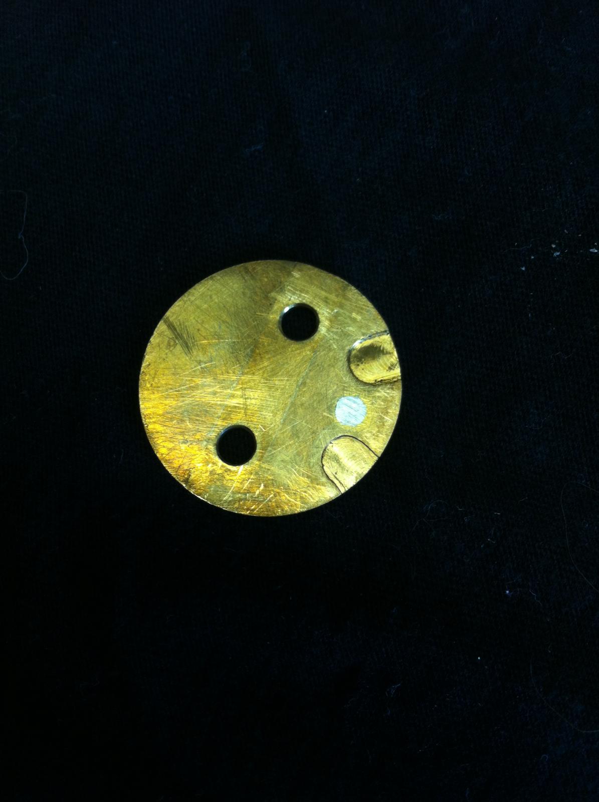

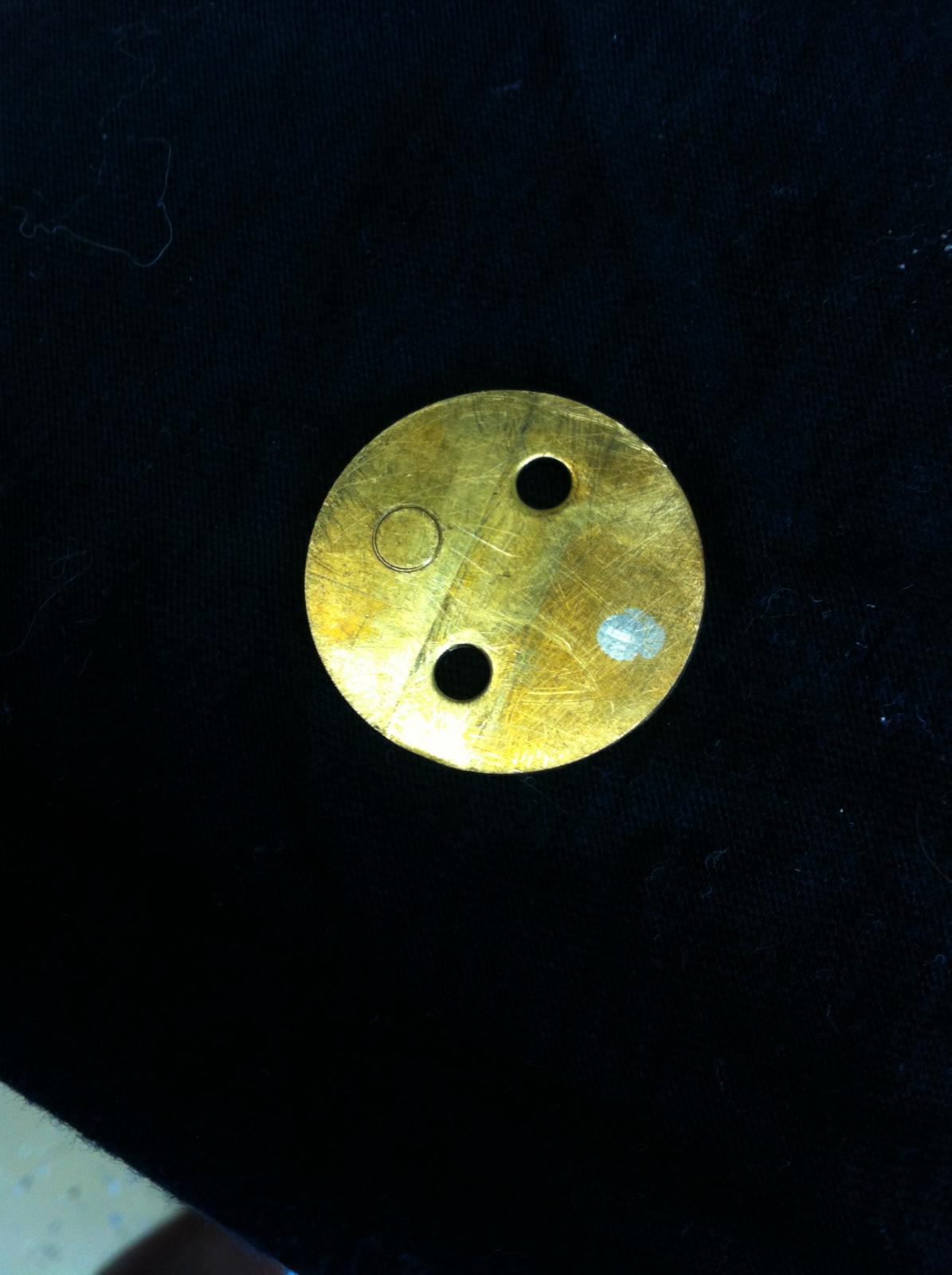

I took the carb off today and seen where the PO soldered in the hole on the plate. Because he was using a 009 diet. I replaced the diet. with a vacuum one. I am going to drill out the hole to see if this helps.
