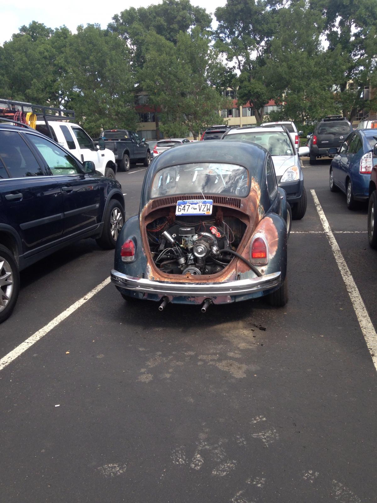

The night I got the car I stayed up all night and swapped the 1600 dp by myself in the middle of the road. I required all the engine/tailight wiring the next day since it all melted in the fire. Started up on the first try!
I've also stripped the interior of all the tar boards and threw in a carpet kit I had left over from the '73 after I stopped all the surface rust. The car looks a little rough, but it's a solid body and pan which is all I wanted. It drives like the miles are low. I'm now moved up to Fort Collins, and living in an apartment with the bug right outside my window. I have an adjustable 3" narrowed beam with drop spindles, drum to drum, under my bed that should go on any day now. I'm not completely sure what I want to do with this car, but in the near future I'm just going to put this beam on and reminded the rear and roll around real low. I'm thinking in the future I'll do air, starting with just air shocks up front and then bags in the rear eventually. Then bodywork and paint and stuff.
First day driving to classes
You can see the hose coming off the alternator stand and the kind of filter I have. It has a nipple on the filter, should I hook those up? Or just find a stock oil bath filter to put on there?
For now I have a question. The oil filler area has that hose that originally connects to the oil bath air filter. My engine doesn't have that, I have a crappy chrome filter. It has a male nipple that the hose fits over, should I put it on there? I'll add a picture in a little while.

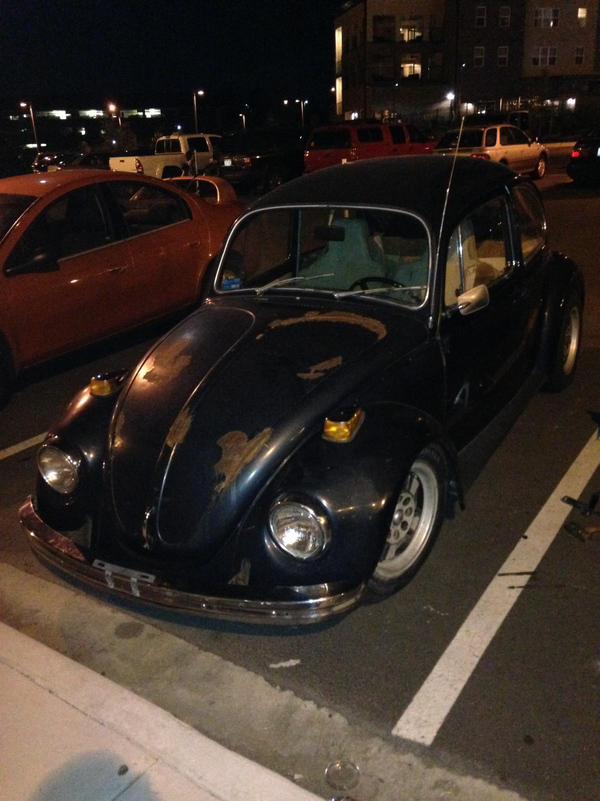

Here it is getting towed up to college!
And the view from my apartment window, next to my dd Very Happy
I fixed most of the oil leaks, coming from the valve covers and the strainer, but it looks like its still leaking from some pushrod tubes. Should i get some of the nicer collapsable ones? Or just do the ones that require removal of the heads?

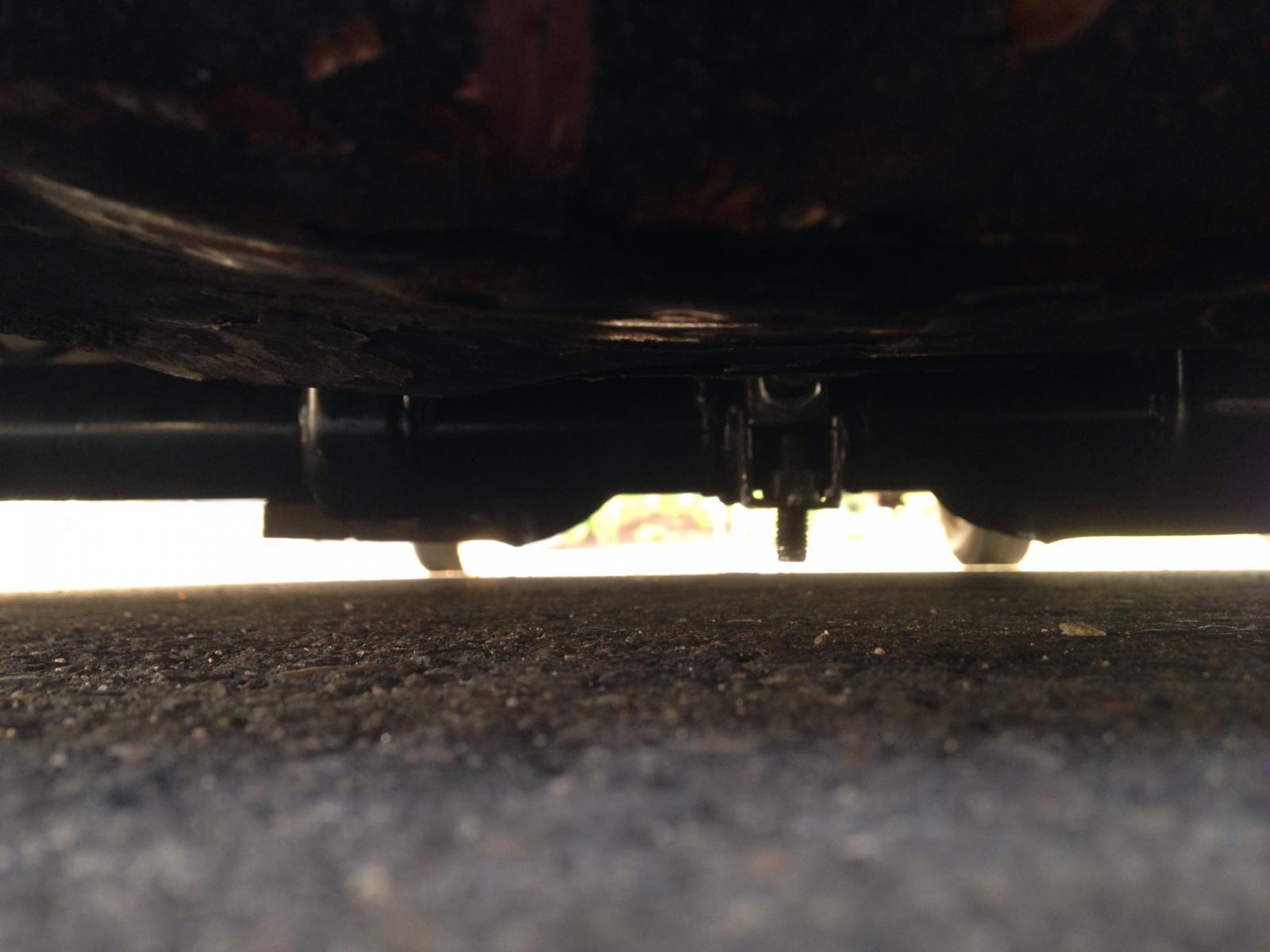

So I had a few free hours today so I decided to tackle swapping my beam!
This was the first time I've had the front end apart besides pulling the wheels off to swap to my rivis since they had good tires and the stocks it came with didn't.
I pulled both of the tie rods from the pitman arm and spindles so I didn't have to move the tank since I just filled it up
I figured it would be a pain in the ass since on my last bug it took me a few days to get the tie rods and balljoints off the spindles they were so rusted on, but a few taps with a hammer and they popped right out!
Had a few of my roommates help lift the beam up to the panhead and everything went smoothly from there.
I dropped the car back down on its wheels after finishing everything up and...
It gets caught up on the tires Mad
Im pretty sure my adjusters are all the way down and with drop spindles so Its not that surprising since I'm only on a 3" narrowed beam. I need to get my stock wheels back and figure out what to do with tires now.
It looks way better though!!!
Still need to reindex the rear, not sure how many clicks I'll go just yet...
Anyone have any tips on tire sizes? I have no idea what to run up front. I'd like to be really low though. And I think I decided I'll run stock wheels all around until I get some cash then get some widened 4 lug, probably around 7", for the rear Twisted Evil

smart car tyres bro, 145/64/15R

155/55 will properly be okay, be aware any of these lower profile tyres lower the car even closer to the ground than it already is, they are pretty small!
have a read here to get an idea
http://www.thesamba.com/vw/forum/viewtopic.php?t=247735
I have only used 145/65's

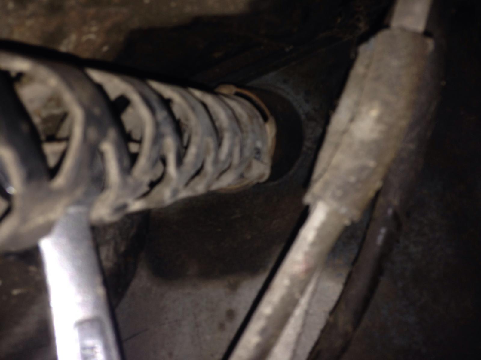

So today I went about trying to figure out my alignment, attest get it acceptable to where I can drive it once I get my new tires and wheels.
Both sides had an obscene amount of toe in, so I corrected that.
Something came up though. My steering is squeaking and really rough to turn, and sounds and feels like metal on metal. I look underneath and ee that the steering column is rubbing against the sleeve Question Im not sure what to call it
Pictures explain it better. The expanded part is rubbing up against the tube it goes into
Im not sure how to remedy this... or why it happened. Any tips?

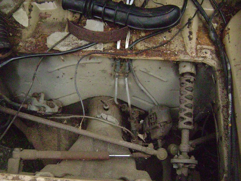

So I found how it needs to look. In this picture there is a gap betweent the expanded part of the steering shaft and the steering tube.
Mine are touching. Should I just listen the two bolts under the column and try to pull it back? How should I go about this?

I got the new tires mounted and put on! They're so small haha.
The stock wheels look good and now theres no rubbing at all, even when I turn full lock I'm pretty sure... Why do people ever go narrower than this? haha
Adjusters are basically all the way up and I'm this low... haha not sure how I'm gonna deal with that. Guess I need to get air shocks sooner than later.
I also pulled the tank, fixed my steering, and re-did the brake line right there and added a fuel filter.
You can see how I got there to be a space between the shaft and the tube.
It ended up being one of those splined flange things was too far down on the shaft forcing it into the tube. Easy fix and I needed to do that fuel line anyways.

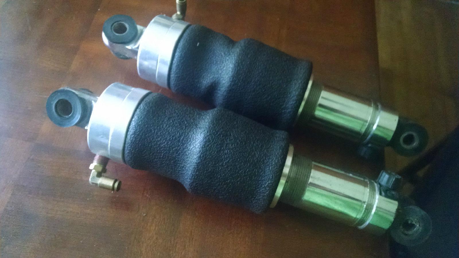

So I've been really thinking about air ride... and decided to go with monroe air shocks up front, probably with a 5 gallon tank and a viar compressor. I won't being ordering it immediately, but later in the future.
I'm not sure what to do about the rear though...
I was thinking I could remove the torsions, and strengthen the stock shock mounts by gusseting them and stuff. Then run something like these
I would probably have to clearance some things around it, but I don't see how this wouldn't work. People say the stock shock mounts weren't made to hold the cars weight, so if I reinforce them wouldn't that fix that?I'd like to do it as unobtrusive as possible and this looks like a good way to go. Can anyone tell me why this might not work?

In the pictures, it looks like your beam is adjusted to the full down position, not full up. Put a decklid on that thing before dumps something down the oil fill and fubars your engine. Oh a stock oilbath would be a better choice.

Nope, It's all the way up... I have no question about that. And it has a decklid on it now. And I would run a stock oil bath if i had one, but i haven't seen any come up for sale local.
I drove it a few laps around the parking lot today, and the knocking sound is gone... So now I'm really confused. I guess I'm just gonna ignore it until it comes back haha

I had a little time today to mess with the bug, and I got the rear down to a decent level. Definitely looks much better.
I really like it haha
It actually scrapes less now that theres less rake. Drives a lot better like this too
