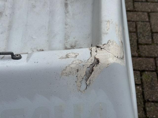

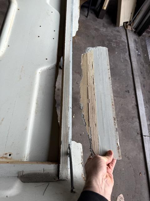

I'm in the process of restoring the poptop on and have stripped it down for painting. However, I've uncovered several issues that need addressing before I can move forward.
Current damage issues:

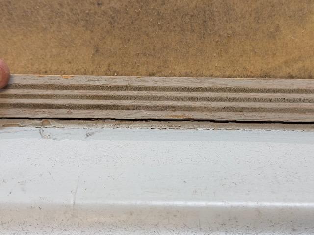

Fiberglass/polyester damage: Corner of the luggage rack has cracked and chipped polyester (see attached photos 1 & 2 which is an old repair which i partly sanded away). Front edge of the poptop has significant polyester damage (photo 3).
Wood problems: The wood frame is separating from the back of the poptop (photo 4). Wood piece shown in photo 5 appears damaged and may need reinforcement
What is the best approach to repair the fiberglass/polyester damage? Specific filler products that match well with the original material? Recommended adhesive to reattach the delaminating wood to the fiberglass? I plan to repaint after repairs, so cosmetic perfection isn't critical, but want to ensure structural integrity and proper water sealing. Any photos of similar repairs or product recommendations would be helpful. Has anyone here done similar fiberglass and wood frame repairs on their poptop?

Degrease BEFORE sanding. use a degreases that can also remove silicones. then sand both sides, sand course to give good bit into the surfaces, more so on outside so you can feather in the patch.
You glass cloth to effect repair from both sides, well overlapping onto the good material
Cloth is good for over all strength, mat is good for impact resistance. many times mat is laid down over cloth.
then final shape...
the fiber filled filler is oft called kitty hair filler. it is useful on thicker sections of fill. the glass bead is easier to sand, smoother, but shant be laid on as thick as the kitty hair
cure then sand outside smooth, then paint.
That is the basics, how I have repaired a glass kayak.
An epoxy (two part) is probably a good choice for the wood adhesion, again degrease before sanding sand rough so glue gets a good bit into the surfaces
The reason to degrease first is that sanding over grease, wax, silicones will tend to smear these contaminates into the material. Sanding can roll material over on itself and create deep narrow trenches that the contaminates cant be removed from later with a degreaser. This will make loss of adhesion.
