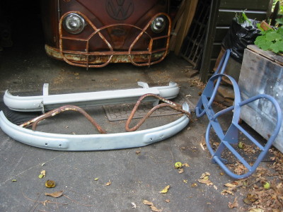

The Hurst bumpers have extra brackets as well as the bar that goes from left to right.
The Hurst brackets are white in the pic above.
The original brackets are grey.
Those early bumpers through 58 are just flimsy.

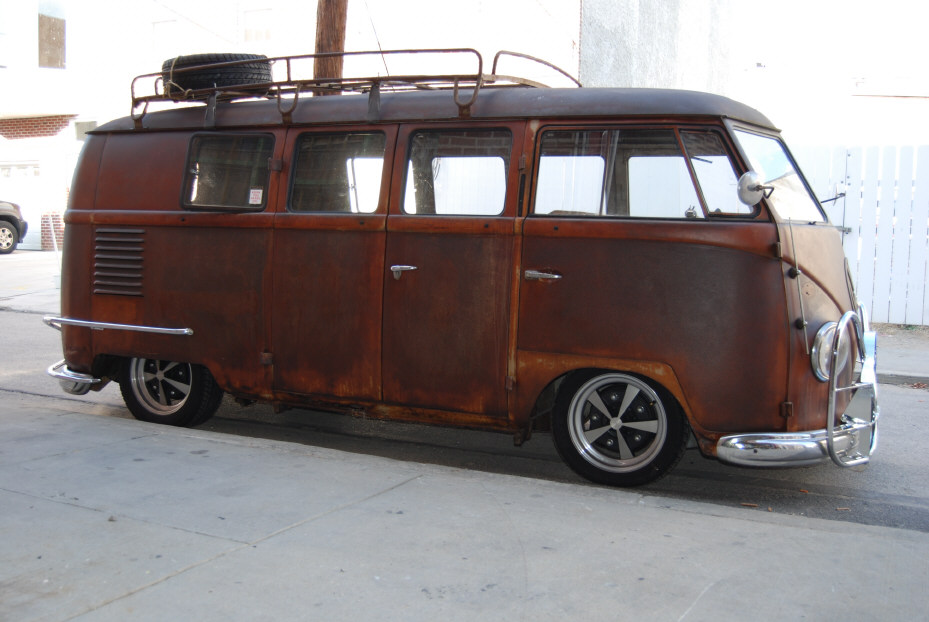

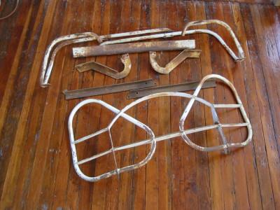

On original Hursts early and late rears is where the lower tube stops. Early stopped at the lower mounting bolt on the bumper, like the one pictured above. On the later ones the tube extended past the mounting bolt on the bumper and wrapped into the wheel well some. But both types were for use on pressed bumpers. I think all repros out now are the early hurst style and that is the style you need to run on your late bumpers so they can sit farther back and you won't have the tube bent in to the side of the bumper or battery corner.
Here's a picture Clara posted. This is the best one I could find of late Hursts, notice the lower portion of the tube going into the wheel well.

I see what your saying for the "OG" style.... but for repros, your saying they commonly look like the top pic, but modified to fit properly?? Someone mentioned it's a bracketing thing for the repros...

i've never seen these "early" rear hursts. every set i have had have all been this "late style"

That's funny Gibbs. you said this in 06
UZI wrote:
that bus EmpiGT found appears to be a late 57/58. it also has the same type of rear hursts as the KING panel. i'm thinking the kind that snub off at the rear bumper are an earlier version.
Alot of discussion about this on page 3 of this thread
http://www.thesamba.com/vw/forum/viewtopic.php?p=1425695&highlight=#1425695
