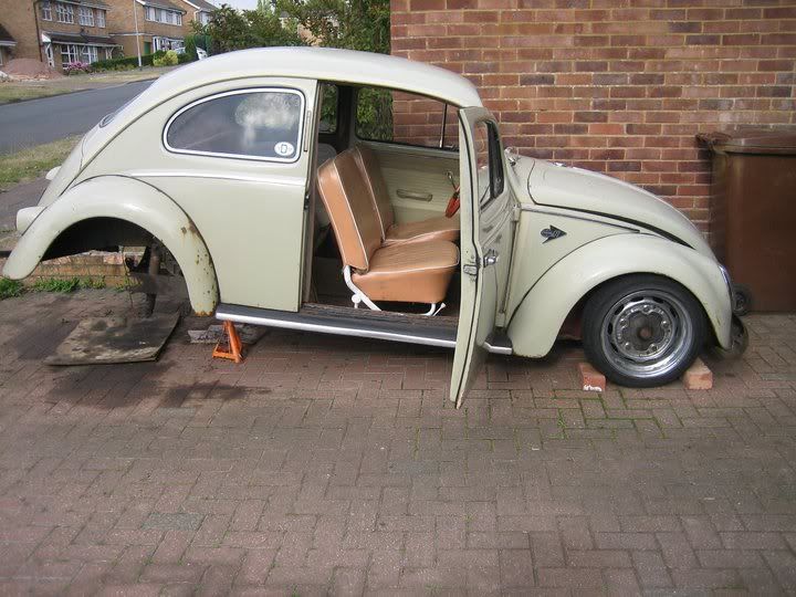

hi there im pretty new to the site as im struggling to find this mount for my beetle.. was wondering if anyone out there could help me out Sad they seem super hard to find and a pain in the arse!!! hope someone out there can help me.. i just want to drive me bug

just a quick picture
hoping some of you guys out there know so i can get it off the axle stands!! Razz

picture of the mount needed Sad

Front transaxle mounts are discussed a lot for the earlier Bugs because of people changing from one style transaxle to another. Just to make sure, are you going to be installing a split case transaxle in your 1960, or a full syncro tunnel case transaxle? That one-year only front mount only fits a one-year only split case transaxle with matching nose cone.

if installing a tunnel case trans into a 1960 beetle you have to use a 1960 only front mount.
if installing a tunnel case trans into a 1959 and older then you use a 59-67 type2 bus front mount. also both 59 and older and 1960 use a bus nosecone and bus hockey stick. please keep this info in mind snort.

ahh now this is interesting what you guys are saying.. i am putting a later gearbox in but i do have a split screen nose cone and stick fitted.. as the early box that was in it was broke. it looks ok from the old mount untill it broke

PostPosted: Wed Oct 23, 2013 12:32 am    Post subject: Reply with quote
just did this myself. used a tunnel trans, with bus nose cone and hockey stick. Welded the front mount off a newer bug. Thats the easy part. Now the tricky part is lining up the hockey puck up right. if you just you the stock holes it wont work.
