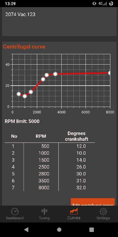

Hi all. I need some help with the curve. 123 tune+
My engine is in a T2a panel van
92 x 78
Webcam 218/119
AA500 35 x 32 stainless valves, untouched
Rockers: 1.1
Compression 8.7:1
CB Hi Flow manifold
37 Pict-3, 30mm Venturi - jetting: 160 main, 65 idle, 80z air correction
Vintage Speed exhaust
Gutted oil bath cleaner with K&N
Pertronix coil, Taylor leads
123 Tune+
Spark plugs NGK BP6ES
Deepsump, external filter, no additional cooler
I'm currently using this curve from somebody else. So certainly not the best.
It drives fine, no stumble, can accelerate from 30 km/h in any gear without hesitation.
From what I've gathered this centrifugal advance curve shouldn't be too bad
in terms of fairly simple, all in at 28°
But when it comes to the map curve I admit I'm lost. I don't get it.
Epecially the part
some moderate vacuum advance of 7o or 8 degrees at whatever maximum vacuum value your engine pulls.
I see a lot of -0.6 and -0.7, on ocassion -0.8 on decelaration and when caressing the pedal.
But what do I do with that info?
I haven't driven much to get to this point
Again, take your time to think about how manifold pressure is displayed on the app and how it is entered into the curve. Again, It's not intuitive, I think. But it is logical.
So I have this map curve from a friend with a 2 liter and a 38 pict3
Is it safe to run that?
Any tips or hints you can give?
I have an upcoming big trip next week and hope to see a bit clearer after that.
Or should I just shut down the map curve and run without until I have a better understanding?
