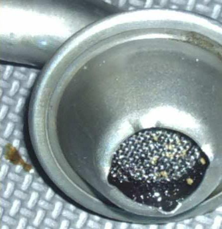

Just want to reiterate the point made here, with some pictures of modern oil pick-up tubes. Seems like a good plan to keep the screen with filter, since that engineering is still used. I clean these when replacing oil pans, so with a filter, they don't need regular cleaning, but also not forgotten.
