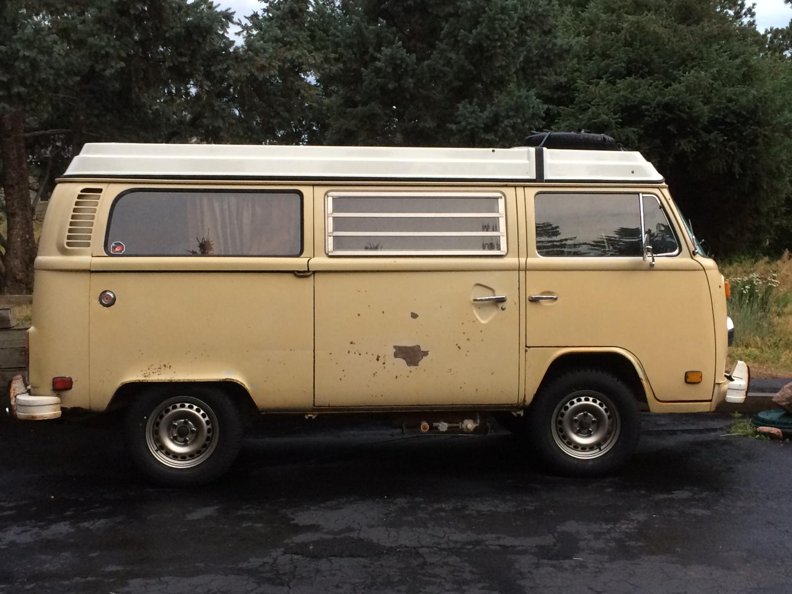

While considering this as an option, I searched all sorts of keywords to find help and could not find any build thread for this conversion. So I thought I would pop the cherry on this, my first build thread.
I have wanted to do this on a few of my projects (Airkewld T3 Disk Brakes, 2.5 Vana-baru swap, 16" Merc wheel to Vanagon, etc, etc) but seem to get into something else and can never find time. Those types of projects are easier to find help on here in the forums, so my motivation is greater for this project.
I found a set of bare wheels in Boulders C.L. for $50 and just could not pass it up. It worked out perfect for me because my neighbor/ drinking buddy has good friends in the Northern part of our state so I talked to one of them about picking them up for me. Even better, they had planned to get together that weekend already so the wheels were delivered the 2.5 hours right to me...anyway. Needing tires on the Bus for an upcoming adventure, I started studying the internet to see how easy or difficult this was going to be. With info scarce I had to just do it and learn along the way..
My Bus is a 1978 Westfalia full camper, stock and slow 2.0 FI...smooth as cream-o-wheat.
(and don't make fun of my exhaust, its next)
The wheels are 15" x 6" ET 45 Italian Steelies 5 x 112 lug pattern. Center bore opened up to 66.56 makes a nice tight fit around the Front hub. This was done for me by a great shop here in Colorado Springs named Absolute Machine. These guys were eager to help, affordable ($30 per), and had them done before lunchtime.
***Do your research before you buy your steelies, I saw ET #'s in the 50's on some VW wheels. I lucked out and found a set real close to stock dimensions which are 14 x 5.5 ET39
After a little Scratchin' and Squirtin' (Dupli-Color "Pewter")
The tires I found as the best option for me were the 215 70 15 Yokohama Geolander ATS. They are a good split between on and off road traction and load ratings were just at spec at 1653 lbs (98s) and they are a really good looking tire.
The night before the tire shop visit I could not sleep well at all, fears of rubbing and clearance issues haunted me. If there were any issues it could cost us our upcoming trip and I would be in big trouble due to it being our 10 year Anniversary gift to each other. My guts were in knots.
Fortunately...NO RUBBING!!! YAY!! They fit great and really stand the Bus tall, its Rocky Mountain Tough now. Lets go!

So this was just straight bolt on without lifting at all? (except for the center hole cut and different lugs right?)

Yes, pretty simple really. Lugs are 14mm Ball Seat and everything. There is more room too, could have gotten away with 215 75 I think.

Just got back home where its at least 10 degrees cooler than down in the Springs, its so nice!
The trip went great, smooth and stable on the freeway and nice and responsive in the canyon. And not alot of power loss in the hills. I had a little rubbing on the front sway bar at full stop while reversing, but I can handle that. Nothing forward that I noticed. All in all, I am extremely happy. Very Happy

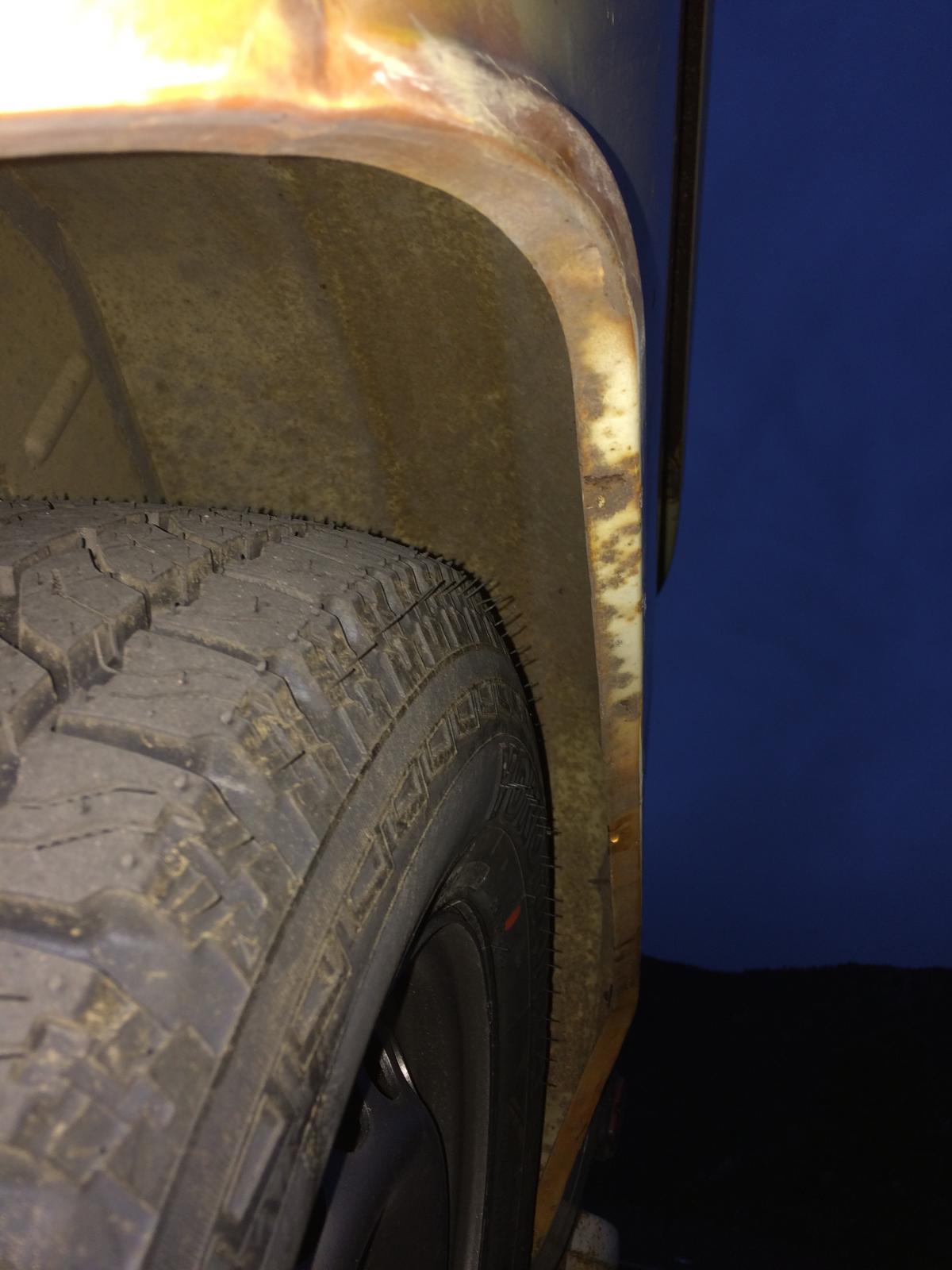

PostPosted: Tue Aug 18, 2015 12:08 pm    Post subject: Reply with quote
Here is what I found stamped on the wheel
Here is a shot up to show great clearance between fender and tire
These tires measure at 26.8", this info can be found on Discount Tires site.
I do think the 215 75's would be fine, you would have to adjust your "u-turn" style though.
As far as how much lift...I didnt measure but its got to be at least 3-4" over my "P" rated 185 75 14's

PostPosted: Mon Dec 21, 2015 6:05 pm    Post subject: Re: Bay Bus with Passat (or late VW) 15" steel rims whe Reply with quote
Busstom wrote:
And thanks to he who bumped this thread...interesting option, wish there was an easy way to add hubcaps.
To tristessa: I had the same results that you appear to have achieved with Rustoleum's hammer finish paints - some areas turn out smooth, other areas turn out hammered...apply light, apply heavy, no matter, no difference...waste of time, might as well go smooth for a quality look...disappointing product.
I'm happy enough with the Rusto hammer finish; this isn't a show rig, and it's forgiving enough to touch-up with a spray can and have it blend in.
I've toyed with the idea of adding clips and using a pre-'71 hubcap but not having A) clips B) an early hubcap or C) an extra rim to play with, I won't really pursue it too hard...
