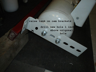

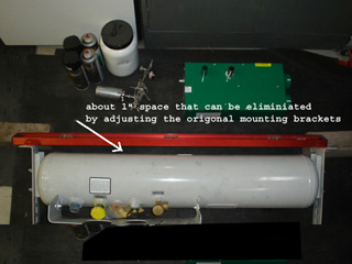

PostPosted: Fri Nov 19, 2010 4:06 pm    Post subject: Oversize B/D Propane Tank Install Reply with quote
Last edited by Energy Concepts on Wed Dec 15, 2010 9:26 am; edited 2 times in total

Thanks for those pictures. I got my tank the other day and needed this. I also am curious about the mounting strap.
Is each strap one piece? Two?
Does each end of the strap bolt to the nuts I see welded to the undercarriage, even on my 90 Multivan?
I assume the welded nuts are for the original propane tank but I've never seen how that original tank bolts up, so I'm guessing.
What did you use as a source for the straps? I'm certain the bolt up is easy but as they say, a picture is worth a few words.

Oops. Another question.
Regarding the mounting bracket that you drilled out to regain that extra inch . . . Do you use that more as a stabilizing foot against the undercarriage in conjunction with the tank strap or do you bolt it through the pan?
Thanks Again,
Evil

PostPosted: Sat Nov 20, 2010 9:34 am    Post subject: Reply with quote
Each strap is one peice
Each end of the strap bolts to the nuts you see welded to the undercarriage.
Source: I believe Zoltan wen to Home Depot, grabbed some straight zinc coated metal and bent them. He also grabbed some rubber lining they sell there to cushion it between the tank and the strap.

PostPosted: Sat Nov 20, 2010 9:36 am    Post subject: Reply with quote
I didn't drill out the mounting bracket. I got rid of hte mounting bracket. The mounts the bracket bolts to on the tank have a flat top that is held tight against the undercarriage there by keeping the tank from rotating.

PostPosted: Sat Nov 20, 2010 9:47 am    Post subject: Mail I sent to the Bus Depot Reply with quote
Ron from Bus Depot contacted me. Here's my reply to him. It explains what Zoltan did and some adjustments I'm putting on my list of "To Do's".
Hi Ron,
As for mods and alterations, not much at all was done to the tank itself. Just two holes drilled in the valve guard/shield so that the bracket to hold the regulator could be bolted to it.
As I wrote this, I realized there's lots of room for improvement over my current setup which I will no doubt institute.
Here's a list of the things that were done to make it fit.
1) The two factory mounting brackets that came with the tank were not used. The part welded to the tank that these fasten to does however play a key roll in mounting the tank.
2) Two U shaped mounting brackets were made for the tank. They were bent at both top ends with holes drilled in them so that they could be screwed into the factory bolt hoes. Factory bolts were used to do this. A thin strip of rubber was laid betwen the bracket and the tank.
3) Positioning of the forward bracket on the tank is important. The bracket must go between the fill spout and the forward most nozzle. (you can see in the picture. Otherwise you will cover the hole to the sink drain.
4) A couple extensions were added to the copper propane pipes were made so they would reach the regulator but, if you used a different design and mounting location for the regulator bracket, you might not need make these.
5) As it is the cap for the sink drain can no longer be put on since the tank butts up right against it. However, I have not yet investegated if the mounting bracket could be moved up over the last nozzle on the left thus moving the tank back toward the water tank drain. There might be room.
6) The tank came with brackets welded on each end. These have a flat top. The U shaped mounting brackets when tightened hold this flat top flush with the underbody of the van. This helps prevent the tank from rotating. Even if the tank was to rotate, the guard mounted to the tank would not touch ground. I tested to make sure.
To derive how much clearance I lost, I eyeballed the lowest point underneath the van to the ground and compared it to the lowest part of the propane tank (the guard). It looks to have only lost one inch.
Hope this is helpful.
-nod7

PostPosted: Sat Nov 20, 2010 10:38 am    Post subject: Reply with quote
Nod7,
Thanks a ton! I'm ready to proceed. Two follow up questions:
1. Re: the bracket that the regulator was bolted up with . . . this came with the regulator (Bus Depot) or was simple fab'd up by your installer?
2. Re: the bolts, strap and stock nuts welded to the pan . . . did you simply a bolt from bottom up OR thread a bolt top down and secure with a nut from the underside? The welded nut seems tack welded on (not strong) and another contributor here showed himself using a bolt going from the top of the pan down, threaded through the nut and then secured with the strap and locking nut, etc.
Thanks Again.
eDNA
1990 4 Speed Orly Blue Multivan
nod7
Joined: July 14, 2010
Posts: 160
Location: Seattle
nod7 is offline
PostPosted: Sat Nov 20, 2010 3:00 pm    Post subject: Reply with quote
1) Fab'd up by my installer Zoltan. He made it of the same steel he made the straps from. So this gives you an ide of how rigid the steel is you use for the straps
2) My bolts were sticking down and we just slid on the straps and put a washer & nut on them. I thought that the bolts comming down were stock. They seem welded in place on my van. Mines an 1987. Were thes stock mounting setup for the propane tank different year to year?
