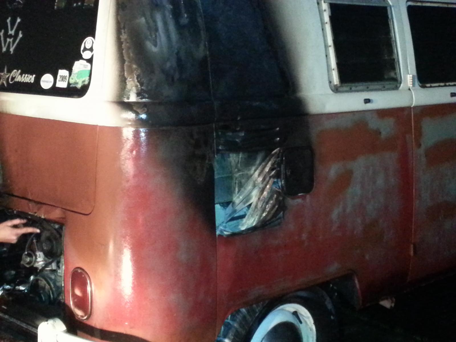

I think fuel filter failure. It was maybe 3 months old and located on the left battery tray area where I thought if it were to leak it would not leak on the engine and ignite. Going to do all threaded fuel lines on the next one.

RPGreg2600 wrote:
Ok, so what happened was I was in the car pool lane with in traffic doing about 40, the rest of the lanes were moving about 20. The pedal all of the sudden lost it's springyness and the engine died. My initial thought was that the throttle cable had snapped. (It had snapped about a week ago and I band-aided it by bending 2 hooks in the cable) I was on my way to skinner's shop to get some window seals and a throttle cable. I put my signal on and started cutting acorss traffic as quick as I could with no power. I came to a stop blocking the two right lanes. By then I'd realized the engine was not running so the throttle cable was not the issue. I looked back to see black smoke starting to fill the back of the bus. It get's a bit foggy here, but I either looked back or in the mirror or opened the door and saw flames coming out of the vents. We all piled out of the bus and freaked out for a second. I grabbed the front bumper and pulled the flaming bus off the freeway. Unfortunately as soon as the front tire came off the pavement the bus picked up a ton of speed and there was no stopping it and it turned right into the ditch and struck the freeway sound wall, which actually wrinkled the top of the dash.
The bus was towed to Skinner's shop and he will be handling the claim for me. Upon inspection of the engine compartment and throttle cable, the reason the pedal hit the floor was that the return spring on the carb had gotten so hot it lost it stretched. So the bus must have been burning for a bit before the engine died. And the bus was running great right till it stalled out. The fuel line probably completely melted off about the same time the spring melted which is why the engine died at about that time.

PostPosted: Sun Dec 23, 2012 6:20 pm    Post subject: Reply with quote
Amazing what the heat did to the vents...
But still, it doesn't look that bad. I'll bet it could be saved.
One of the firemen hacked those vents... I think it was the same one that hacked up the rear end and decklid after the fire was out.

PostPosted: Sun Dec 23, 2012 10:55 pm    Post subject: Reply with quote
Wow, even the glass didnt break. Really thinkin this can be fixed.

PostPosted: Sun Dec 23, 2012 11:31 pm    Post subject: Reply with quote
The motor doesn't look melted. Look at the dizzy it's still intact.

PostPosted: Mon Dec 24, 2012 12:38 am    Post subject: Reply with quote
ditto on the dizzy. cap is still there too. Wondering if any magnesium really got going at all, maybe the fuel leak just kept going.

PostPosted: Mon Dec 24, 2012 12:39 am    Post subject: Reply with quote
One rubber vacuum line to dizzy vacuum can also still there.
