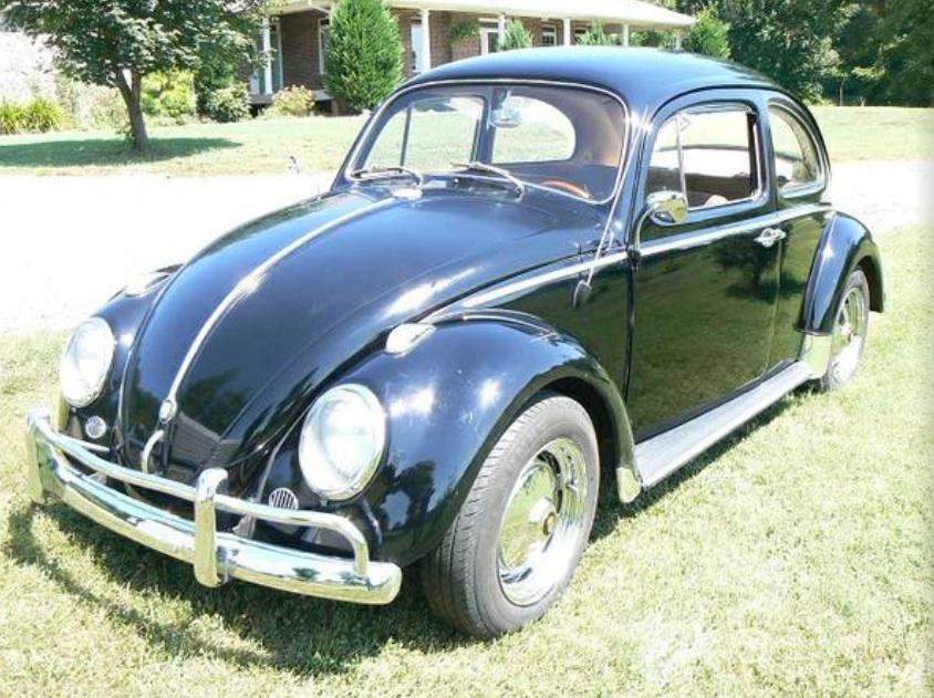

I just bought at '63 Deluxe Beetle. According to the VIN number, it was made in August of 1962.
So do I really have a 1962 or a 1963?
For example, 1963 cars see to have heater outlets under the rear seat, but 1962 models do not. But I am figuring when it was sold, it was rolled out for the 1963 sales year so it's called a '63.
Just want to make sure that I know what I have when ordering parts, etc. I know many parts span lots of years but there are many, of course, that don't.
Thanks.

lojoma
Joined: May 28, 2012
Posts: 248
Location: Memphis
lojoma is offline
PostPosted: Fri Aug 14, 2015 8:39 am    Post subject: Reply with quote

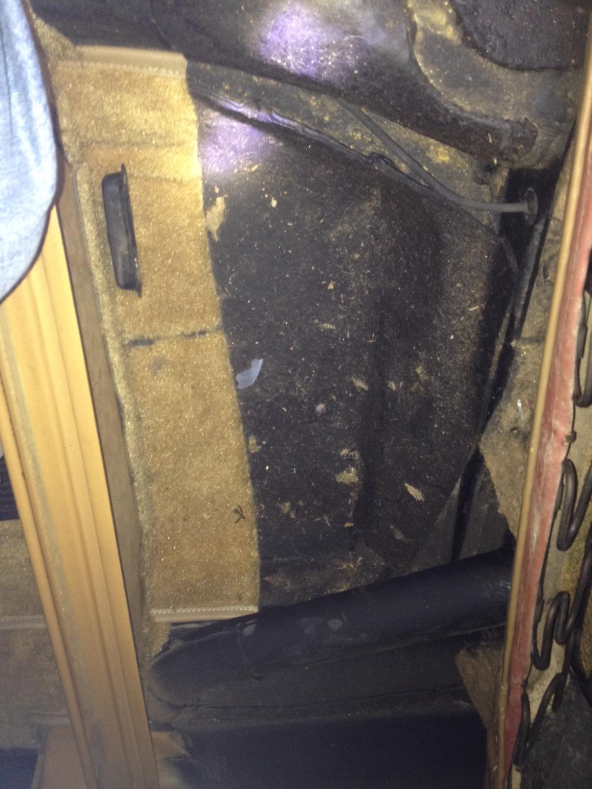

It does have the crest on the hood. It does not have heat outlet under rear seat. The heat does work.
The engine is a '74 engine. (AH code).
I posted photos to my gallery for you to see. The car was restored about 15 years ago. Paint is good but not great, but the pans are in amazingly good shape and I can't find rust anywhere on this car. A few bolts here and there have light surface rust. Previous owner took very good care of it.
The photos have an aftermarket steering wheel, but he put the original back on when I bought it.

Well...my heat ducts appear to have been removed some time ago!
The change to the '74 engine added fresh air heat. I guess they decided to push all the heat to the front for some reason.
I thought earlier ones didn't have outlets in the back because the '62 manual I looked at didn't mention adjustable flaps on those outlets like the '63 manual does, and I didn't see any on mine! Interesting.
