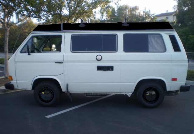

Any one painted their top black?> please post as i am seriously considering this. Having to do some fiberglass work and wanting to refresh the look of my Ivory 81 Smile
Thought was to clean/ prep/ and use Truck Bed liner....similar texture...

just post an image of your rig... I will paint it black for you to preview and decide you like it or not..
Very Happy
I was bored so I did quick one:
Not the OP's van but same difference, yes? Razz
~Kamz Anxious
