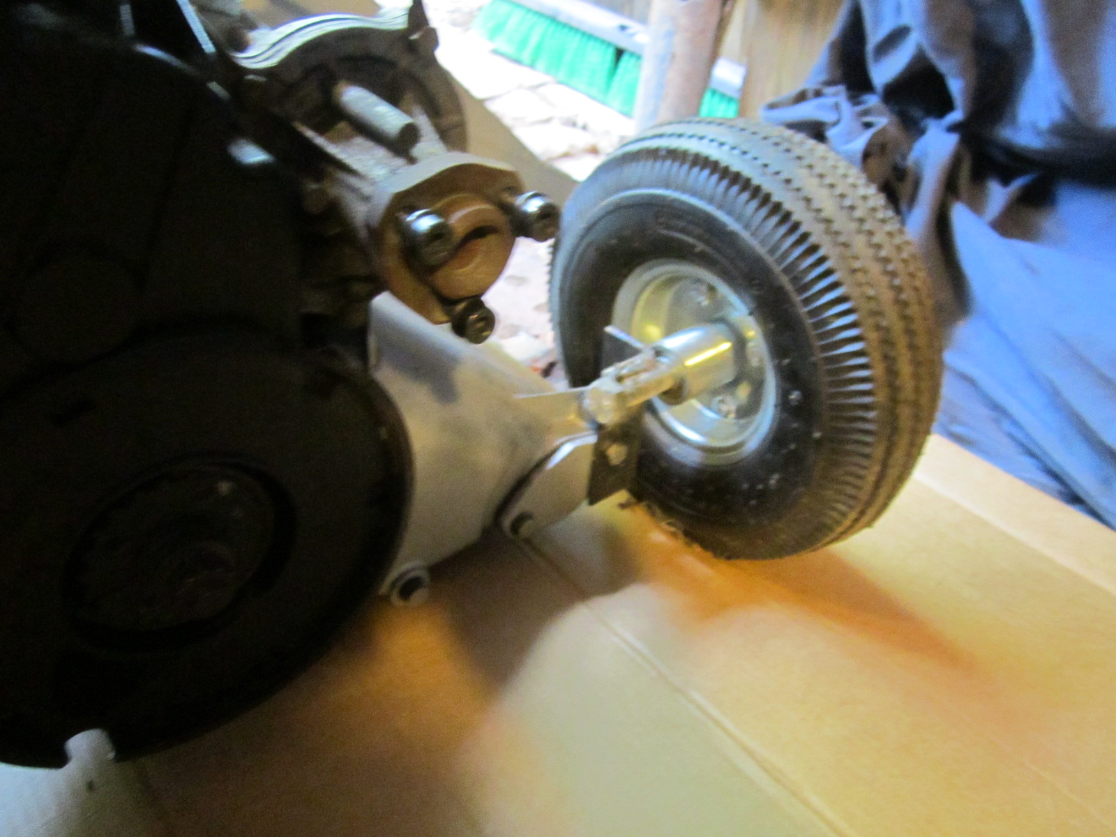

Finally I was able o test my wiring experiment on an extra AHU engine I have. I was able to get this setup running in my shed using a bell housing and starter. The motor runs well and response to the throttle even only being connected the pump, RPM and number 3 Injector sensor. I'm very happy that everything works but I'm I’m sure it threw all kinds of codes Smile
Here are some concerns about the things I still have to do:

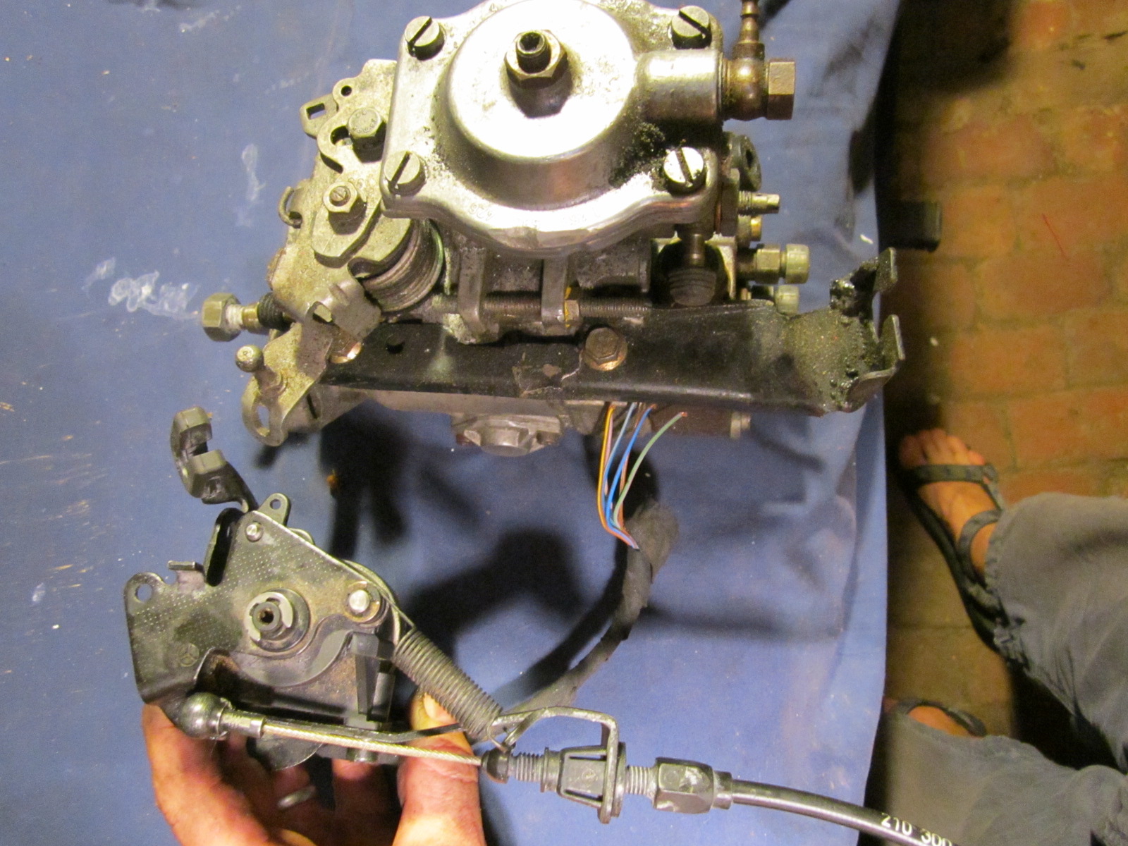

1. Placing Throttle sensor
I have 3 sensors: original AHU, VW VR6, and Mercedes E320
I like the Mercedes sensor the best since it is made to be placed in the engine compartment and is actuated by a wire and a conventional foot paddle. This way I could leave Vanagon pedal and cable original.
I’m not sure yet if the Gasoline sensors could work.
2. Where would be the best location for the ECU?
Here are some pictures of my experiment:

storing the extra Motor Smile

Here is a chart I made to compare the signal for 3 different Throttle sensors.
Has anyone ever tried to use a VW gasoline throttle sensor for an AHU?
Mercedes sensor would be great to place in the engine compartment - even the ball connector for the throttle cable fits!!

For now I used the original AHU Throttle sensor and placed it in the engine compartment. It is actuated by the original Diesel Vanagon throttle cable.
