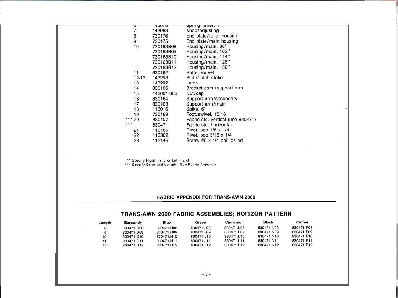

Moderator notes so you don't have to sift through the topic to find them:
Trans-Awn 2000 Owner's Manual, including mounting instructions: http://www.thesamba.com/vw/archives/manuals/trans-awn2000/Trans-Awn2000.pdf
Parts list:
https://www.thesamba.com/vw/gallery/pix/1112680.jpg
https://www.thesamba.com/vw/gallery/pix/1112679.jpg
https://www.thesamba.com/vw/gallery/pix/1112678.jpg
https://www.thesamba.com/vw/gallery/pix/1112677.jpg
Parts source: Eezi-Awn 2000 distributors such as http://www.equipt1.com/companies/eezi-awn/ .
Van Adapter Kit (gutter mounts): Dometic part #930035. http://www.adventurerv.net/adapter-kit-van-mounting-p-20187.html

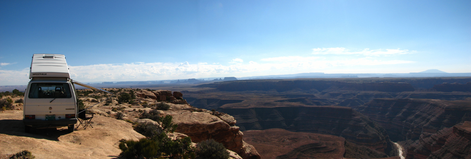

I still have my TransAwn 2000 on the '89 Westy and a spare one in the garage. One "rafter" is slightly bent as well as one clip that holds the case shut. Other than that, it has held up well considering its nearly 20 years old. It handles very well in the high winds of Mulley Point too! The adjustability is a big plus with these.

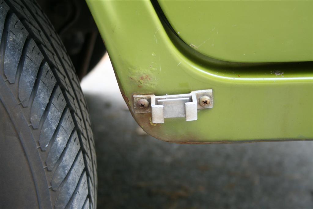

My awning attachments are not attatched to the rain gutters at all, but are attatched to the roof underneath the poptop and also there are two supports from underneath, one attached behind the rear window and one attatched to the piller between the doors. That setup has been bombproof.
I should look around and try to find a used awning to use for parts.
When the wind caught it back in 1998, it also broke the plastic on the end of the awning roller and the rod inside of it that the spring attaches to. I fabricated a new rod and reattached the spring, and it worked for a while but the spring eventually broke again. I guess I could fix it again if I felt the spring was necessary. The plastic part has a hose clamp around it that has been on there for 12 years now.

any close up pics of the attachment points where it attaches to the van?

from the pix above mine was supported same spot with one more in middle or rear & front of rear window & post between sliding door & front door , the rain gutter or roof below the pop top damage was not so visible with the awning in place, but once removed the area was stressed cracked and bent downward ...i think it ended up that way from the supports being bent unevenly over time

When I installed mine I had to shim some of the brackets to get all the supports in the same vertical plane -- had I not done this there would have been stress on one or two of the brackets which over time probably would have taken a toll on the gutter.

Ahh, thanks for the pic, an apt reminder to make my way down to those goosenecks. What do you do when you are down there?

Mostly hike, bike, stargaze and read.........as of late, its my favorite spot.

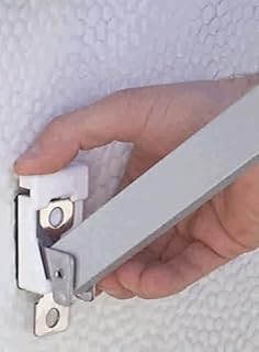

My van has the 8' version and uses 3 support/attachment brackets. It's been on the van since new when the first owner bought it; I've got a "receipt" from the Trans-Awn dealer dated 1989. Surprised
And, I ran into another '90 in Utah (from Idaho) that has a Trans-Awn 2000 as well:
Go to http://www.dometic.com/enus/Americas/USA/RV-Products/awnings/ to find a dealer near you that may be able to get parts for those who need them.
One thing Dometic doesn't have : instructions for installing the wrap-around enclosure for the TA2000 (mine came with the vinyl, screens, floor and "rain fly"). I emailed them and they sent instructions for the later models, which are clearly different. I'm sure I can figure out how it all goes together, but if someone happens to have instructions for the TA2000 enclosure, I'd be grateful for a copy! Very Happy

My van has the same mounting brackets as the white one in the second photo.

Mine too - I sleeved the lower portion in bicycle inner tube to ward off scratching...
