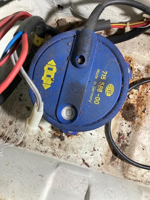

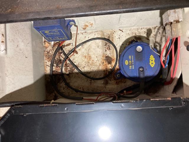

can someone tell me what these relays? are? They are in the auxiliary battery compartment behind the drivers seat. This is in a 1986 westfalia camper

Doing a web search of part number shown in first image I'm getting hits for Hella auto alarm
Doing same for second shows similar. Might be this. Google translate of description shows
I am offering a new (without original packaging) pulse module for towing protection for a Hella car alarm system. This is a private sale, therefore no return, guarantee, warranty, or the like.
https://www.ebay.de/itm/363689581880?hash=item54ad969d38:g:GQMAAOSwyM1bKBDJ

Well that's weird. It looks factory installed. There is a key to the right of the driver's door that it seems connected too?
I'd like to remove it, for an aux battery, but I am a little intimidated as the wiring runs up into the dash....
Suggestions?

It is an aftermarket alarm. Here it is packaged for sale.
https://i.ebayimg.com/images/g/wtEAAOSwGMJa3Klp/s-l1200.jpg
